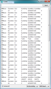

Assuming you downloaded the code from the previous step, load it onto your board and open up the serial monitor.
At first, you shouldn't see anything. Use a screwdriver or your thumb to adjust the onboard pot and you should see some messages pop up.
The pot controls the PWM increment. If you turn the pot all the way clockwise, it sets the PWM increment to 100.
The onboard buttons (BTN2 and BTN3) increase or decrease the PWM signal being sent to our motors. If you press BTN2 now, it will start sending a PWM signal of 100 (a little bit less than half-power) to our motor, which will start it moving.
When you press either of the buttons, you'll see a message with the new PWM output (under "Current"). You'll also see fields with the average, min, and maximum interrupt period (as seen by the board). These will be set to 0, 4294967295, and 0 (respectively). If we wait a little (one to three minutes) while for the board to gather data, a second message will appear that has these fields filled out using the data gathered by the board!
In this way, we can not only control precisely what PWM signal we send to our motor, but also get feedback about how fast it's going!

Twist the pot all the way clickwise again, and hit BTN2 three or four times. That will maximize the PWM signal being output to the motor (should be 255), causing it to spin at it's maximum speed.
After a little bit of waiting, you should get a message like the one above. You'll want to write down the histAvg as PERIOD_MIN. We'll use this later.
