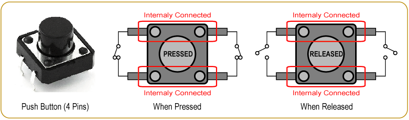

Step 2: Connecting the Push Button
Next, grab a 10KΩ resistor and connect it to the - rail of the breadboard. Additionally, connect a small jumper wire from the + rail of the breadboard to a contact that is near the 10KΩ resistor. It is important to note that a push button contains only two terminals, Terminal 1a, Terminal 1b and Terminal 2a and Terminal 2b. As an example of these terminals, there could be a power connection to Terminal 1a and this power will transfer to Terminal 2b. Using this, the terminal of the push buttons, Terminal 1a and Terminal 2a are connected to the jumper wire and the resistor. Using terminal 2b, another jumper wire is attached to Arduino Digital Pin 2.

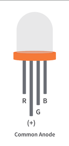

Step 4: Connecting the RGB Led
Since we are using a Common Anode RGB, a 330Ω resistor will be connected to the + rail of the breadboard. Next, the common (longest leg of the RGB Led) will be connected to the resistor. Connect a jumper wire from Arduino PWM Pin 9 to the red pin of the RGB Led. Next, connect a jumper wire from Arduino Pulse Width Modulation (PWM) Pin 10 to the blue pin of the RGB Led. The green pin of the RGB Led is not utilized in this code, meaning you won't have to attach a jumper wire. It is important that the RGB Led is connected to PWM pins, as PWM is used to regulate the voltage being sent to each pin of the RGB Led, allowing for a controlled brightness or color.

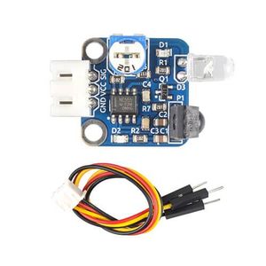

Step 5: Connecting the IR Proximity Sensors
The IR Proximity Sensor will contain three pins, GND, VCC and SIG. To connect these pins, all six of the female to male jumper wires are used. GND stands for ground and can be directly connected to the - rail of the breadboard. VCC stands for power and can be directly connected to the + rail of the breadboard. Finally, SIG stands for signal and can be connected to Arduino Analog Input Pin A0. The same steps will follow for the second IR Proximity Sensor, however SIG will be connected to Arduino Analog Input Pin A1.
