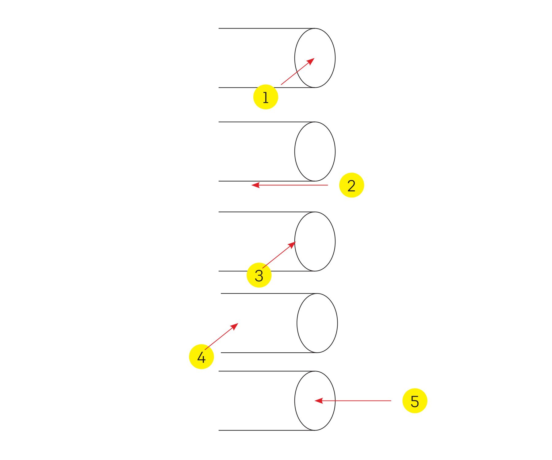

Step 1: Cutting Operations
THE BASIC OPERATIONS WILL ALLOW YOU TO MAKE MANY DIFFERENT SHAPES.
There are 5 commonly used types of cutting operations.
- Facing
- Removing the end of the workpiece, to make it flat as well as perpendicular to the length.
- After facing, but before moving the carriage along the Z axis is a good time to set the Z axis to ABS 0.
- Turning
- Removing material along the Z axis of the workpiece.
- The remaining material can be cylindrical or tapered.
- Profiling
- Using a shaped cutting tool to create a feature, usually a radius or chamfer, on the part.
- Parting
- Cutting straight into the workpiece along the X axis, in order to cut it to length.
- Reduce the RPM to 25% and use lots of cutting fluid when parting.
- Drilling
- Using a drill bit to drill into the end of the workpiece.
