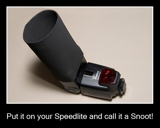

Introduction: Speedlite "Grid" (as Seen on Strobist Blog)
A "grid" is a great accessory to constrain the output of your speedlite into a nice tight pattern. This tutorial was initially released via the Strobist Blog last fall, and is a great way to use up those pesky political signs you find laying around all over the place after election day.

Step 7: Enjoy!
The light is now concentrated in a narrow pattern. The edges of the light pattern seem to fall off more nicely than with my Speed Snoot. Enjoy!

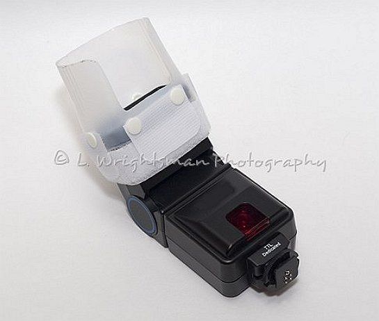

    The Vivitar 283 hood/filter holder is perfect for this. They fit many speedlights apart from the 283. Some may need a bit of velcro on the flash head for a snug fit. All I would need to do is cut to size and drop it in the holder, easy peasey eh! Now where can I get corrugated black plastic in England?

    Hi, Nice idea at first sight, but notice, that Strobist uses black snoot for one purpose - to absorb light flashing in wrong direction. White plastic will not work as good. Maybe try to spray-paint it black inside? Anyway, nice idea.
    0
    andrea biffi
    andrea biffi
    Reply 9 years ago on Introduction
    I think that sprying it should make the surfaces a little matt, and you loose some light power.

    I wonder if you were able to use black spray paint lightly over the inside to lessen the diffusion. Unless that is what you are after... :-)

    This is a nice design. However, one benefit of using black straws is that there's less dispersion of light. Using white plastic allows the light to bounce and diffuse far more than what occurs with black.

    Nice idea! A bit more diffuse than a snoot, but more compact and I'd guess you lose less light.
