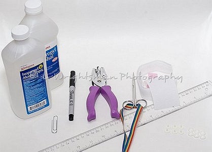

Step 1: You'll Need...
You'll need: Ruler, Scissors, 2 wide velcro, Tiny hole punch, Sharpie, Paper Clip, Isopropyl Alcohol bottle. For attaching the velcro, six poly-resin snaps or a needle and thread.

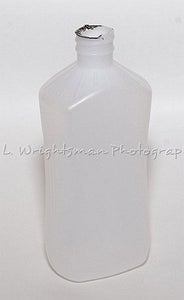

Step 2: Step 2
Empty and dry the alcohol bottle, then remove the label.

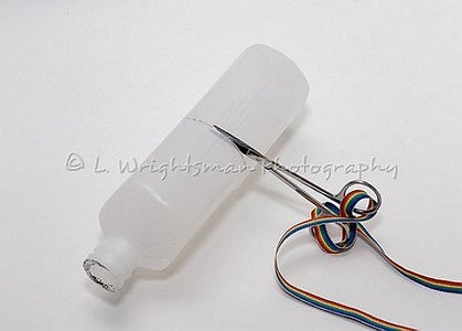

Step 3: Step 3
Using a piece of string or a rubber band, draw a guide line around the bottle with the Sharpie marker.
Step 4: Step 4
Using the scissors, cut the bottle on the guide line.

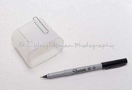

Step 6: Step 6
Now slip one end of the bottle over the top of your flash and put the large paper clip on the end of the bottle opposite the flash.
Step 7: Step 7
Use the Sharpie marker and Paper Clip to draw nice guide lines -- the rounded end of the clip makes drawing a curve easier.

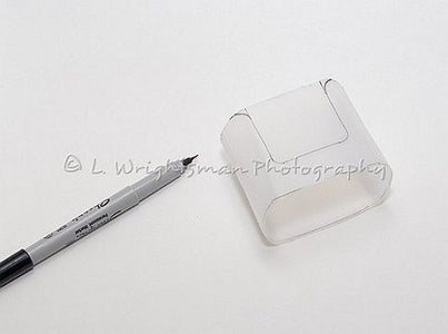

Step 8: Step 8
Mark a line across between the two guide lines you just made, and also curved lines at the top on each side.

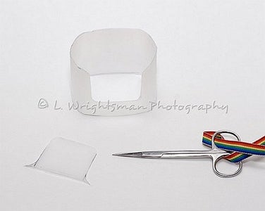

Step 9: Step 9
Cut the section you just marked on the guide line.

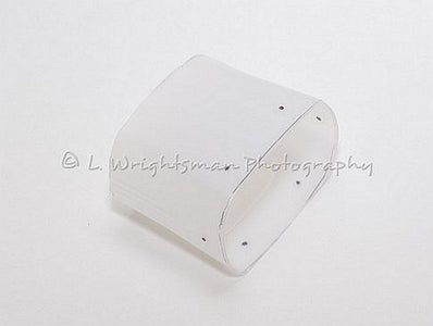

Now mark dots 3/8 inch up from the bottom of the bottle edge opposite the cutout that you just made. This edge will be towards your flash in the finished product.
Step 11: Step 11
Make six such marks, two on the long side and one on each of the short sides.

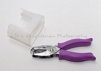

Step 12: Step 12
Use your tiny hole punch to punch out the dots.

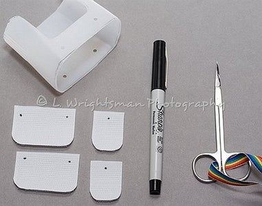

Now cut your velcro hook parts into three equal sections, and further divide one of those sections into two smaller sections. Round the bottom corners and transfer markings to the velcro to match the holes you just punched in the plastic.
Step 14: Step 14
Use your tiny hole punch to punch out the marking dots on the velcro.
