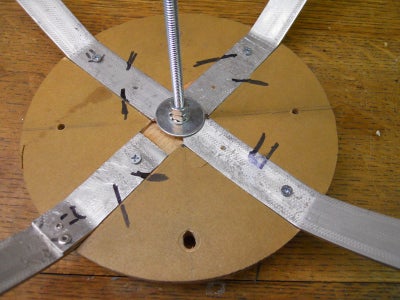

  • Used a scrap piece of marine grade plywood that was big enough to cut a 8" diameter disc from.
  • Find the center for the disc and drill a hole just large enough for the threaded rod.
  • Cut a perpendicular dados using the center hole as the center. The dados were as wide as the aluminum bar. Which was 3/4", and 1/8" deep, same as the aluminum bar. The tighter the fit the better.

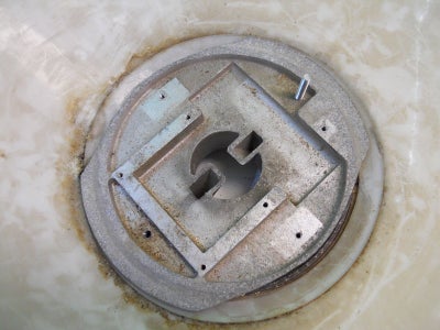

  • Using the removed flange(that mounts the bottom acrylic shell to the base, marked and drilled the mounting holes. And drilled two 7/8" holes to run the wires for data and power out through the bottom into the base.

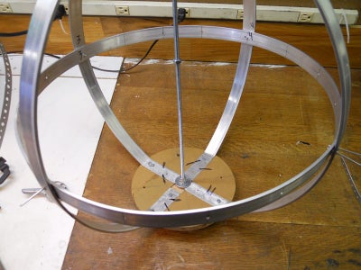

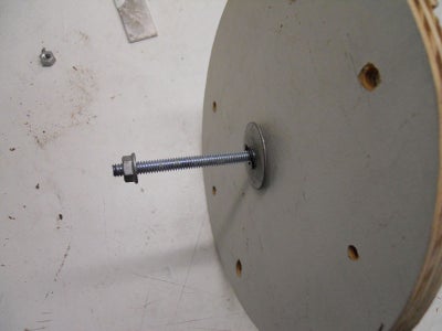

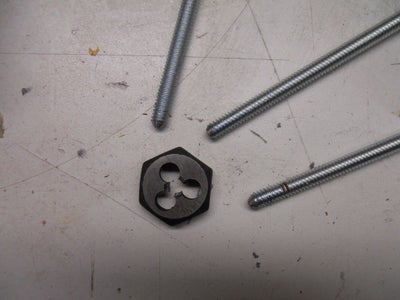

Center Support Rod:
  • The threaded rod was left long for now but all the bolts and washers were installed. To keep it together each bolt has a lock washer and the inside has 2 bolts for each side that are tightened into each for extra hold. Wide washers are used to help stabilize it.

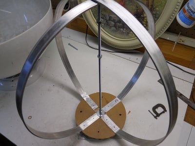

Vertical Support Bars: It helped for this step to have a wooden disc/template the same diameter as the support structure, which is 18" in this case. Since the ring rollers aren't precise or consistent and its hard to tell when its the right size, its easiest to have something to compare to. Although after completing this project, it would be best to only use one instead of the two shown, as the thickness caused some issues because they intersect at the top. Which also meant they weren't the same and were slightly different to try and make up for it.
  • Calculated the circumference of a 18" diameter circle and cut two lengths of 1/8" x 3/4" aluminum bar.
  • Marked the center and drilled a hole, same size as the threaded rod.
  • Used some scrap bar to get the ring roller close to the right diameter, then rolled the support bar into full circles.
  • Checked them against the template and adjusted.
  • Hardest assembly part is to find where to bend the aluminum bar to flatten the bottom for mounting to the base plate and flange. Used the center hole as the top reference, the wooden disc/template, a straight edge and a measuring tape(like for sewing, since it has to bend to measure the round object precisely)
  • With the top center marked and already knowing the distance from the top of the support bar to the base plate, the straight edge was used to mark the bar, then measured(with the tape) from the top center hole, and adjustments made, since both marks should be an equal distance from the top center hole.
  • Hammered the aluminum bar flat at the marks, careful not to distort the rest of the shape.

Equator Support:
  • Rolled from 1" aluminium bar, trial and error to make it fit good inside both lateral supports.
  • Installed the base plate with the vertical supports and center support rod into the bottom of the acrylic shell.
  • Used the acrylic shell(which is exactly half the sphere) to find the exact position for the equator support. Clamped and marked both the equator support and vertical support for drilling and riveting.
  • Cut it to length so the ends sat flush together with the seam behind a vertical support. Each side got a pop rivet.
  • Left it installed til after the metal strapping was installed, so all the rivet holes could be marked then drilled.

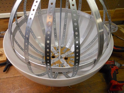

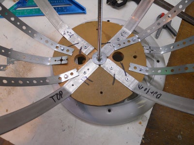

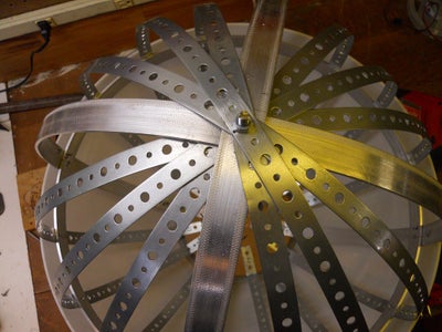

Step 5: Finalize Support Structure
Used for the rest of the support structure was perforated metal strapping, for hanging pipes and other construction uses. The standard stuff found at hardware stores is too thin at 28 gauge, but 20 gauge was found online(eBay/Zoro.com)
  • The strapping was still too thin to put through the ring roller, but it unrolled fairly well so it was formed by hand, using the wooden disc/template of the right size.
  • It was cut to length with enough extra to bend and screw it down, and the center of it placed onto the the threaded rod.
  • The first one as trial and error to get it correct, by using the equator as a guide the diameter was figured out and the bottom of was bent to line up with the base plate.
  • Then the holes in the strapping were counted and used as a measurement to make the rest the straps the same as the first. There are 6 pieces of the strapping but if this was done again, and one of the vertical support bars were removed, there would have been 7.
  • The metal strapping was positioned(as best as possible) and screwed to the base plate using self tapping hex headed screws.
  • Lastly the metal strapping was pop riveted to the equator support.

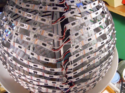

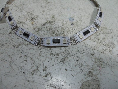

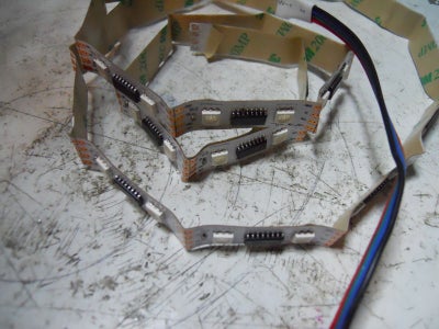

Step 6: LED Strip Installation
The type of LED strip was chosen over other types for a few reasons. See Pixel Chipset Comparison
  • Pixel density, used here is 48 LEDs/Meter LPD8806. Other choices were 32 LEDs/Meter(WS2801), which was not enough. Or 60 LEDs/Meter(WS2812B) which was way too many. The rows should be the same distance apart as the pixels are on the strip, so the total amount of pixels can quickly get pretty big with the higher density strips.
  • Control and Data Rate, LPD8806 can accept data really quick over other options which allows higher frame rates. The control scheme is really simple, but unfortunately only has 7-bit color.
  • Cost and Availability, already had it in stock and its on the lower end cost wise vs the other chipsets.
  • Drawback is the 7-bit color and the strip is cuttable every 2 LEDs rather than every 1 like some types.
Installation:

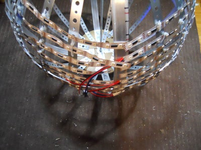

  • Layout a control plan, where the first LED will be, the direction the strip will go and where the last LED is etc.(see attached image of patch for details)
  • Pick a direction and always run the LED strip the same direction(left to right or whatever)
  • Started on the equator, pulled the LED strip off the spool and cut it to length after it was applied. Didn't always make a full rotation, so there was a small gap left.
  • Using the same spacing as the LEDs, the next row up was applied and cut to length. Made it as straight as possible.
  • The middle rows are pretty flat and easy to mount as the rows went up higher and got more distorted the best method was to carefully bend/pinch the LED strip on the seams to make it sort of accordion. The change of the shape allows it to conform better to the shape of the sphere. But to much broke a few pads that had to be soldered back together.
  • As the LED strip was placed, the occasional zip tie was used to keep the LED strip in position since the adhesive was not going to help very much other than initial positioning. The LED strip didn't quite match up with the holes in the metal strapping, if built again a way would have to be found to make the holes match up with the LED spacing, as it would have made it a lot easier.

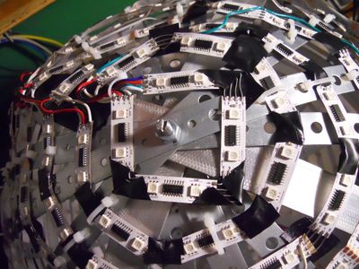

  • But at the very top top that method won't work, and LED strip rings had to be made for each row. Using single sections of LED strip and solid strand wire. Then taped to prevent shorts, but shrink tube should have been used.

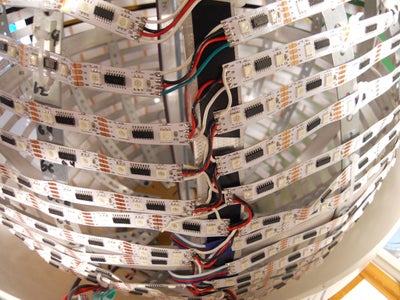

Step 7: LED Strip Wiring
Wire It Up:
  • With the layout plan ready, start wiring. This sphere is divided into two sections, top and bottom hemispheres. This leaves the option controlling them as one string or in two strings. The top half is considered the first string, so it has JST-SM connector on its DATAOUT, that DATAOUT can be connected to the bottom hemispheres DATAIN to make it one string, or the top and bottom DATAIN can be connected separately.
  • First cover the aluminum bar, where all the connections will be made, with electrical tape to prevent shorts.
  • Used solid strand to connect in series all the +5v and GND connections on the LED strip. (White and green wire, meant to use green for all the grounds)
  • Then used some 2-conductor twisted wire to connect the DAT and CLKs in series(red and black wire, also should have been different colors, but that is what was available)
  • Last some 4-conductor ribbon cable with JST-SM connectors was soldered to the data in of both strips and the data out of the top strip. The wires were made long enough to go out the bottom of the sphere into the base where the controller and power supply will be.

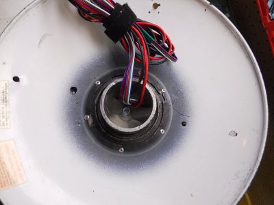

Power Wires: The LED strip can't handle all the current that will run through them, which causes numerous problems(heat, voltage drop, etc) So a few direct connections to the power supply is required. This matrix is calculated to use up to 75 Amps at 5 volts, so it will need some solid power connections.
  • Used some solid strand to snake a +5v and GND wire to every row on the opposite side of the sphere from the data connections. Stripped the insulation back, without cutting the wire and soldered it down to the proper pads. So it is all one piece of wire with solder points along it. Not a great method as the insulation can melt/burn and cause poor solder joints if one is not careful.
  • Then ran 3 pairs of 16 AWG stranded wire(heavy gauge red and black wire) out the bottom, that will connect directly to the power supply.

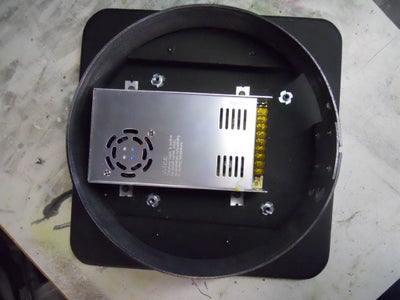

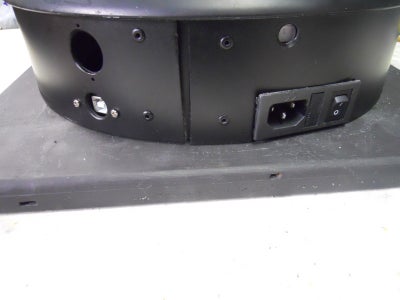

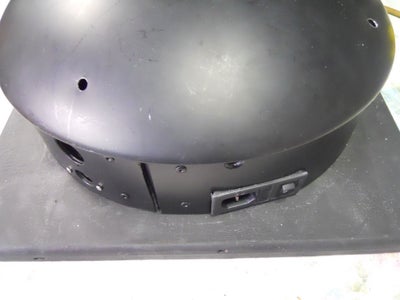

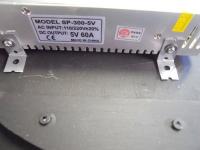

Step 8: Base and Power Supply
The base holds the controller, power supply, wires and connection jacks.
  • A lamp reflector(domed sheet metal) from a halogen floor lamp was used as a lid.
  • 3" aluminum bar was ring rolled to fit inside the lid and form the outer wall.
  • The ring rolled outer wall was dry fit, marked for the AC socket(with merged power switch and fuse), XLR in/out, USB jack, and a hole for the button.
  • Made the cut outs and holes on the outer wall. Test fit everything and made some adjustments with a file.

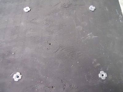

  • A 3/4" thick plywood base plate was made with blocks added to hold the outer wall in place.
  • With the lid on, 4 holes were drilled through the lid into the base plate.
  • The base plate, lid and ring rolled outer wall were all primed then painted flat black.
  • 4x T-nuts were installed into the base plate from the bottom.
  • Built brackets out of metal strapping for the power supply, and secured onto the base plate.
  • The lid was secured to the bottom of the sphere's bottom mounting bracket using pop rivets.
  • Wired up all the power wires, data wires, A.C. wires.(Some connections happen on next step)
  • Cut 4x bolts to length to fit through the lid into the base plate. Tapered the bolt ends with a grinder then re-tapped so they would be easier to insert.

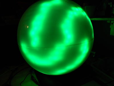

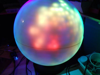

Light Pollution:
After some power up tests and some adjustments to the patch file, it was found that since the interior is all open that there as a a lot of light pollution causing washed out colors and for the support structure to produce shadows on the acrylic sphere. This effect was expected, but not so much of it. So a solution was found to use black vinyl strips, same as vehicle and window decals, as wide as the LED spacing with holes cut out for the LEDs. Vinyl is naturally glossy, so the strips, while still on their backing paper, were sanded with 320-400 grit stand paper to make them matte. They were applied over the entire support structure. Made a huge difference in image quality.
