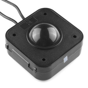

In the video below, Sphero commands the toy car where to drive. It does this through a trackball similar to the one used in a computer mouse or in the arcade game of golf . Sphero sits on the trackball’s wheels and his weight and momentum cause them to move. The wheels have encoders that then tell the car what direction Sphero is moving by sending out x and y coordinates of the movement to the motors. Roll Sphero forward and the car drives forward. Roll Sphero to the right and the car turns to the right.

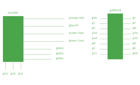

Trackball PS/2:
-After unscrewing the top of the trackball and pulling out the inner ball, cut the end connections of the wire.
-Make sure you have as much wire as you need from the trackball.
There are two black cords:
-One is the data wire where there are 4 wires (orange, blue, purple, and brown).
-The second cord contains different wires where you can include classic arcade buttons. We did not use these, but they work well for I/O pins if you want other inputs for data.
Orange -Gnd
Blue - 5V
Purple(Data) - Arduino Pin 5
Brown(Clock) - Arduino Pin 6
H-bridge:
This is how we control our main motors. After tinning and connecting the motor wires to a header, connect the right motor to the right pin.
1. ENN - 5V
2. A1- Arduino 10
3. m1  - Motor red
4. Ground
5. Ground
6. m2  - Motor Blue
7. A2 - Arduino 9
8. VNN
9. 5V
10. B1 - Ardino Pin 11
11.m3  -  Motor green
12. Ground
13. Ground
14.  m4 - Motor yellow
15. B2 - Arduino Pin 12
16. ENN 5v

Trackball:
-Use Velcro to hold the trackball on top.
-To make sure Sphero Does not fall out, we put in a few bars. Without these, Sphero can jump out of the trackball holder.
-While putting in the bars, make sure not to block the encoders.

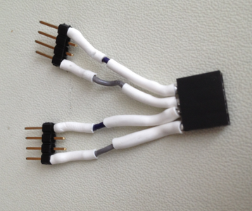

Line Splitter:
img 4, 5
Female header to connect to motors split into two different spacers.
Spacer : 4-header pin with a 2-header spacer for the H-bridge. Outside pins is Motors while inside pins act as a spacer over ground pins
