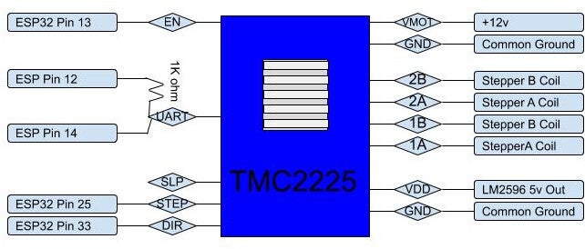

  3. TMC2225 https://amzn.to/3kctdEQ

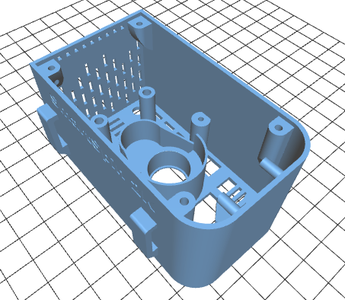

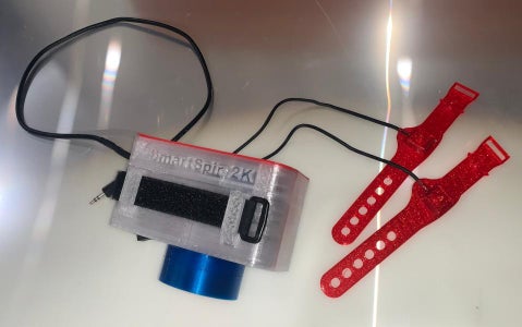

Step 1: Print Parts
PETG works well for all parts except the shifter straps. ABS will also work well.
Shifter straps need to be TPU.
Can also make shifters using other buttons. First version was just buttons covered in electrical tape and they worked okay.
You can find more information as well as the .stl files for the parts over at the projects github repository: https://github.com/doudar/SmartSpin2k/tree/master/Hardware

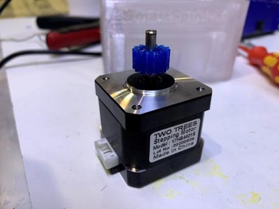

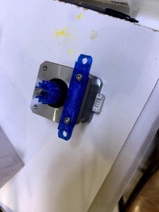

Step 3: Install Gear and Crossbar Onto Stepper
Press plastic gear down onto stepper driveshaft. Secure crossbar to stepper motor with two allen head screws sized M3 by 8mm.
Step 4: Solder PCB
Do NOT solder ESP32 and PCB together until ALL other components have been soldered to the PCB. Follow notes on PCB silkscreen for location and info on components. In testing, the board works with a wide range of capacitor values as the regulator we're using is robust.

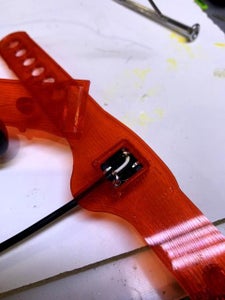

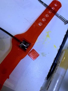

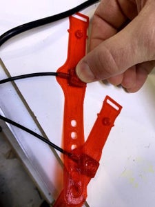

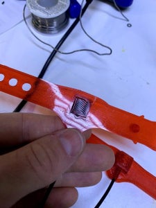

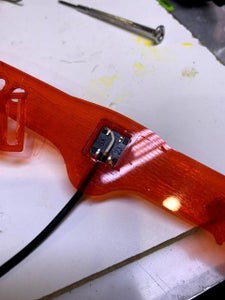

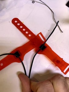

Step 5: Install Pushbuttons Into Shifters
I've found that cutting the RCA plugs off of a 3.5mm to stereo RCA "Y" adapter cable is the easiest (and cheapest) way to make this cable.
Use a cable which is long enough to reach from your shifter location to your SmartSpin2k. Place push buttons into shifter housing, solder as indicated in the photos (so wires are diagonal to each other).
Trim the little square back cover so it fits easily into the back of the strap.
Add a fair amount of hot glue to the back of the button. Immediately put the back cover into position and (while the glue is still hot), depress the button numerous times to get a good button feel from the shifter.

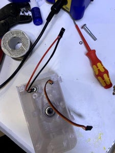

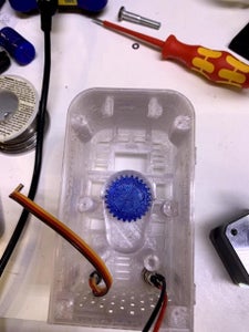

Step 6: Press Bearings Into Case
Two bearings are pressed into the case. Make sure they are flush with the bottom of the case on the outside. You may need to do a small amount of sanding on the case so the bearings fit smoothly, but don't sand too much as we're relying on a nice "press fit" for retention.

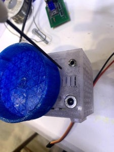

Step 7: Install Knob Cup Onto Gear Shaft
Insert 1/4" washer onto gear shaft to interface between knob cup and bearing on the outside of the case. If needed a washer can be installed on the gear shaft as a spacer inside to prevent rubbing. Make sure your gear shaft and knob cup rotate freely. A small amount of silicone grease is recommended on the gears.

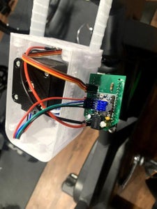

Step 8: Connect Wires to PCB
Make sure the red power wire is connected to the top pin on the PCB for power, with the black ground wire on the bottom.
Connect the stepper wiring harness to the 4 pins on the PCB.
Connect the 3 pins for the shifter to the PCB.
The middle pin on the shifter connector is the common ground to both switches.
Make sure to line the connectors up properly so all pins are in their respective pin connectors.

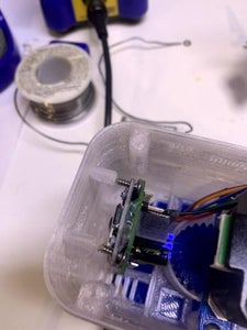

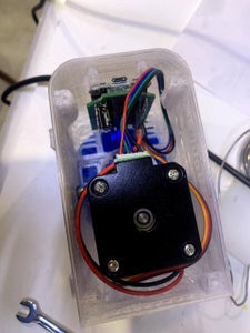

Step 9: Insert PCB Into Case
There are two small nubs on the SmartSpin2k case which will line up with the ESP32 at the bottom of the case. Lower the assembly into the case, then make sure the assembly tilts onto the nibs, then install two screws through the ESP32 to connect the assembly to the SmartSpin2k case. Use #4 x 1/2" flat head screws

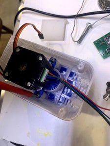

Step 10: Install Stepper Motor Into Case
The stepper motor can now be installed. make sure all wiring goes around the motor and does not interfere with the gears at the base of the case. Take care to install stepper without pinching any wire bundles. Routing the wires above the stepper crossbar should elimnate any interference with the transmission. Use two allen head M3 x 8mm screws to connect the stepper motor to the case through the holes in the bottom of the case. Tighten those two allen head screws gently. Use two #4 x 1/2" screws to connect the stepper crossbar to the case from the top. Tighten all screws securely.

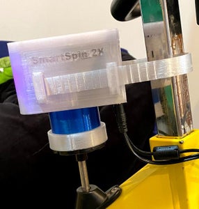

Step 13: Mount SmartSpin2K on Bike
Check your resistance knob is in a light resistance setting prior to mounting the SmartSpin2k. Using your customized knob cup insert in your knob cup, place the SmartSpin2k over the resistance knob of your spin bike. The rounded part of the case should face the rider. Install the bracket around the stem of the spin bike. Insert the shifter cable into the connector on the SmartSpin2k. Plug in the 24V power source and allow the device to power up. Press either shifter button. If the button you press increases resistance (rotates your knob clockwise), traditionally that is installed on the right handlebar. The other button can be tested to make sure it decreases resistance.

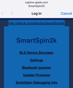

Step 14: Initial Configuration
So you have printed off your parts, followed the build guide, and powered up the SmartSpin2k for the first time. What's left?
On initial boot the SmartSpin2k will create its own Wifi network Access Point with the SSID of “SmartSpin2k”
The default password is **password**
The configuration page will automatically load on a mobile device. If you are not setting up on mobile, the configuration page can be found at http://SmartSpin2K.local/
Click on the **Settings** link
Enter your local WiFi network information with SSID and password. * The default network information is shown in this photo. The MDNS name is a name you can use to reach the SmartSpin2K on your network. For instance if you entered DansBike into the MDNS field, you could go to http://DansBike.local to bring up the SmartSpin2K web page.
On the next reboot, if the latest update is not installed, and the Wifi Network is connected to the internet, the SmartSpin2k will automatically update. You will notice the blue LED will flash quickly while this process occurs. It should take about 3 minutes. Once the blue LED is flashing slowly it is ready to pair bluetooth sensors. Should your local WiFi network not provide internet access, the SmartSpin2k will attempt to connect for 10 seconds, followed by reverting to the default SSID of “SmartSpin2k”.
