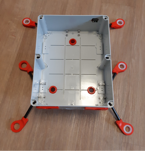

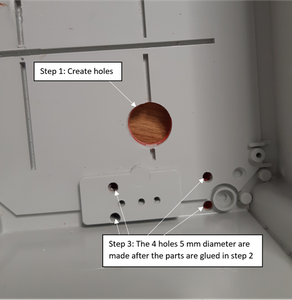

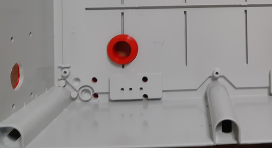

Step 1: Make Some Holes in the Rover Body
The Rover Body is a large ABS electronics box from ABB. The bottom is used to glue the printed parts Glue Bracket Rear, Glue Bracket Front Right and Glue Bracket Front Left.
Before gluing them watch the video on where they must be located on the body.
Then drill the 3 holes. I found it best to be done with a Dremel with a conical grinding stone. This will grind and also melt the ABS, so beware of the fumes from the ABS.
Make sure the holes are large enough so the part Body Wire Plug can be inserted into the glue brackets without a problem.

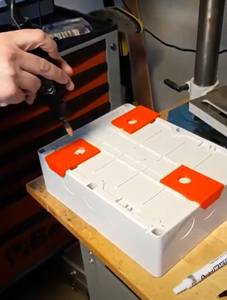

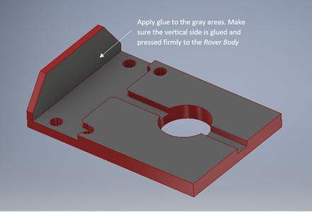

Step 2: Glueing the Brackets
Glue Bracket Rear, Glue Bracket Front Right and Glue Bracket Front Left need to be glued to the Rover Body with 2-component epoxy glue.
This can be any epoxy glue suitable for plastics but be aware that you do not use a glue that has a short working time. You will need some time to glue the whole surface of the parts and position them so an epoxy with a working time of a few minutes is not suitable. I recommend using Araldite Standard and leave the parts to cure overnight.
Since the bottom of the Rover Body is not flat you will have some cavities between the brackets and the rover body. Try to fill the cavities up with the epoxy a bit.
Make sure the vertical sides of the brackets are glued and pressed firmly against the Rover Body.
Step 3: Drill 5mm Holes
After curing the remaining 5 mm holes in the brackets can be drilled into the the Rover Body. This enables M5 bolts to be inserted.

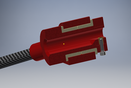

Step 11: Preparation of Assembly Rear
Mount the Brass insert M3 in the Rotation Point Rear in the location as shown in the video above. This must be done with a soldering iron at 300-340 degrees, they are melted in place.
The Closing Hexgaon must be able to slide over the end of the Rotation Point Rear so the insert must be flush or, slightly sunk. Cut away any plastic on the surface if this protrudes (this in general can be avoided by sinking the insert upto 1 mm).
Mount two Nylon bearings from each side (as seen in the video) in one Lever Rotation Bracket, this should be a snug fit and take a bit of force to achieve. Now insert the Rotation Point Rear. It should be able to rotate fully w.r.t. the Lever Rotation Bracket without too much effort.
Also mount two Nylon Bearings in the Lever Frame Rear Left and Lever Frame Rear Right. It may be required to remove some print artifacts by slightly sanding the bearing area with waterproof sandpaper.

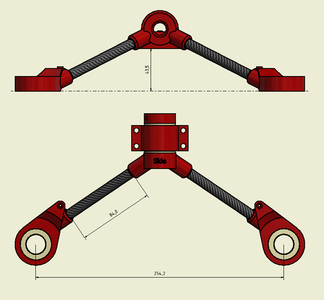

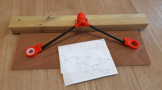

Step 12: Glue Carbon Rods Rear
Two carbon rods are used in the rear, the nominal length is 204mm.They must be glued between the Lever Frame Rear Left and Lever Frame Rear Right and the Rotation Point Rear.
Before the actual gluing of the carbon rods the following two things are important:
  1. The flat undersides of the Lever Frames must be in the same plane during curing.
  2. The bottom plane of the Lever Rotation Bracket must remain parallel to the plane of the Lever Frames during curing at a distance of 43.5 mm.
  3. The part of the carbon rod which is not inside another part must be 168.4 mm as can be seen on the drawing above.
In order to achieve this I used a wooden beam 43.5 mm high an mount a flat wooden board to it as shown in the figure below. The Lever Rotation Bracket can be fixed to the beam with some screws. The distance between the parts (168.4 mm) can be measured with a piece of paper with this size. Adjust the parts so the distance of both rods is correct, and the Lever Frame Rear Left and Lever Frame Rear Right are positioned flat on the wooden board
Step 13: Assembling and Gluing Side
Two identical rod-assemblies must be made for the sides. Per assembly two carbon rods are used The nominal length is 120 mm.They must be glued between the Lever Frame Side and Lever Frame Side Mirror and the Rotation Point Side.
The preparation of this assembly is similar (although other parts) to step 11, the glueing (use the same tooling) is similar as step 12.
Here the following rules apply:
  1. The bottom plane of the Lever Rotation Bracket must remain parallel to the plane of the Lever Frames during curing at a distance of 43.5 mm.
  2. The part of the carbon rod which is not inside another part must be 84 mm as can be seen on the drawing above.
Once the glue is cured you can mount the 2 side rods and the rear rod to the Rover Body with M5 bolts.

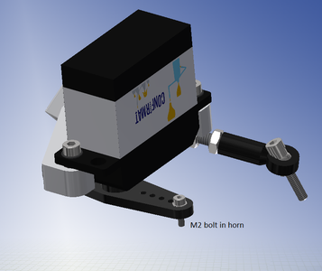

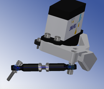

Step 15: Assemble Servos

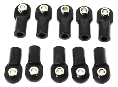

Mount the 360 servos to the ServoMount Wheel and the 210 servos to the ServoMount WireConnector Right and Left. This must be done with three M3x12 bolts each, Use the rubber bushing that is provided with the servo. Also screw the horns (with drilled 2 mm hole) to each servo.
For the 210 servos also add the Ball Joints using a 32 mm long M4-wire rod (all can be sawn from a 1 meter wire rod). The distance between the ball joints must be about 50 mm.

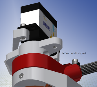

Now you can mount the Wheel to Servo Connector (including the M2 nuts) to the Tapered Bearing Shell. The Connector is secured to the wheel with the M5 bolt (wheel-side) and nut (connector-side).
Add the horn of the servo motor, assembled in step 15, with the M2 bolts and washers. The servolead needs to be routed through the Upper Wheel Flange, and the Vertical Wheel Rotation Axis.This is not shown in the video. The rooting is shown in the photo-collage however (only not the part in the Vertical Wheel Rotation Axis). It can be seen that the Closing Plate is used to keep the servolead in place.
Do this and finally mount the Upper Wheel Flange and the Vertical Wheel Rotation Axis.

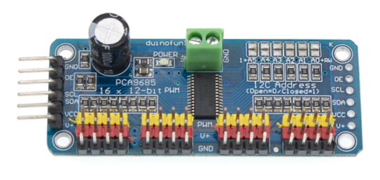

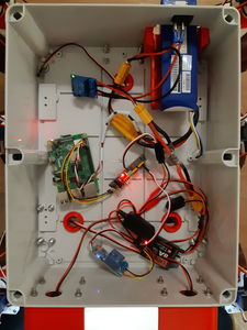

Step 19: Connect Electronics
Connect the electronics as shown in the diagram. The switch is the switch that you already mounted in the Rover Body.
The order in which to mount the servos to the PCA9685 is mentioned in the Pi Setup.
