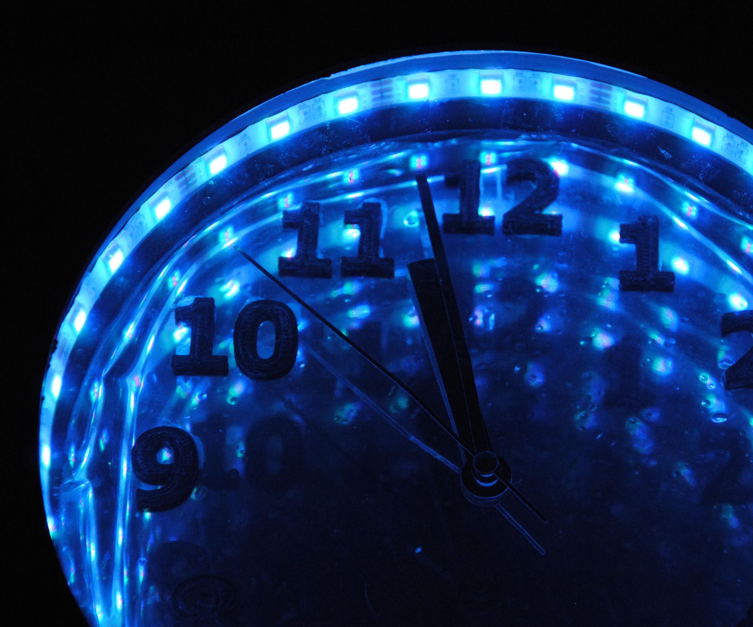

Step 3: Epoxy
This is great stuff. It's thin. It's crystal clear. It sets hard. I love it.
This epoxy is easy to use. Mix 50-50 ratio stir for 3-5 minutes pour the form full and presto when it dries you got a hard clear surface. The only problem I had here was I did not get the cavity totally sealed up. So my advice is take your time double check make sure that every little crack is sealed with Kwik Seal then fill the cavity around the lights in with the Epoxy Resin.

Okay so I said earlier that some of my epoxy ran out on me. So after that epoxy was dry I added some more. Well I got it a little full.
So I thought no problem I took some 150 grit sandpaper and sanded it down. Then I took some 220 grit sandpaper and finished it down.
Then I wiped it clean of dust but and sprayed it with a can of aerosol lacquer. But I forgot about about how PLA would respond to lacquer. It turned milky white.
But when it dried down it actually looked pretty good as the opening picture at the top shows. It is not 100% clear like before but I am satisfied.
