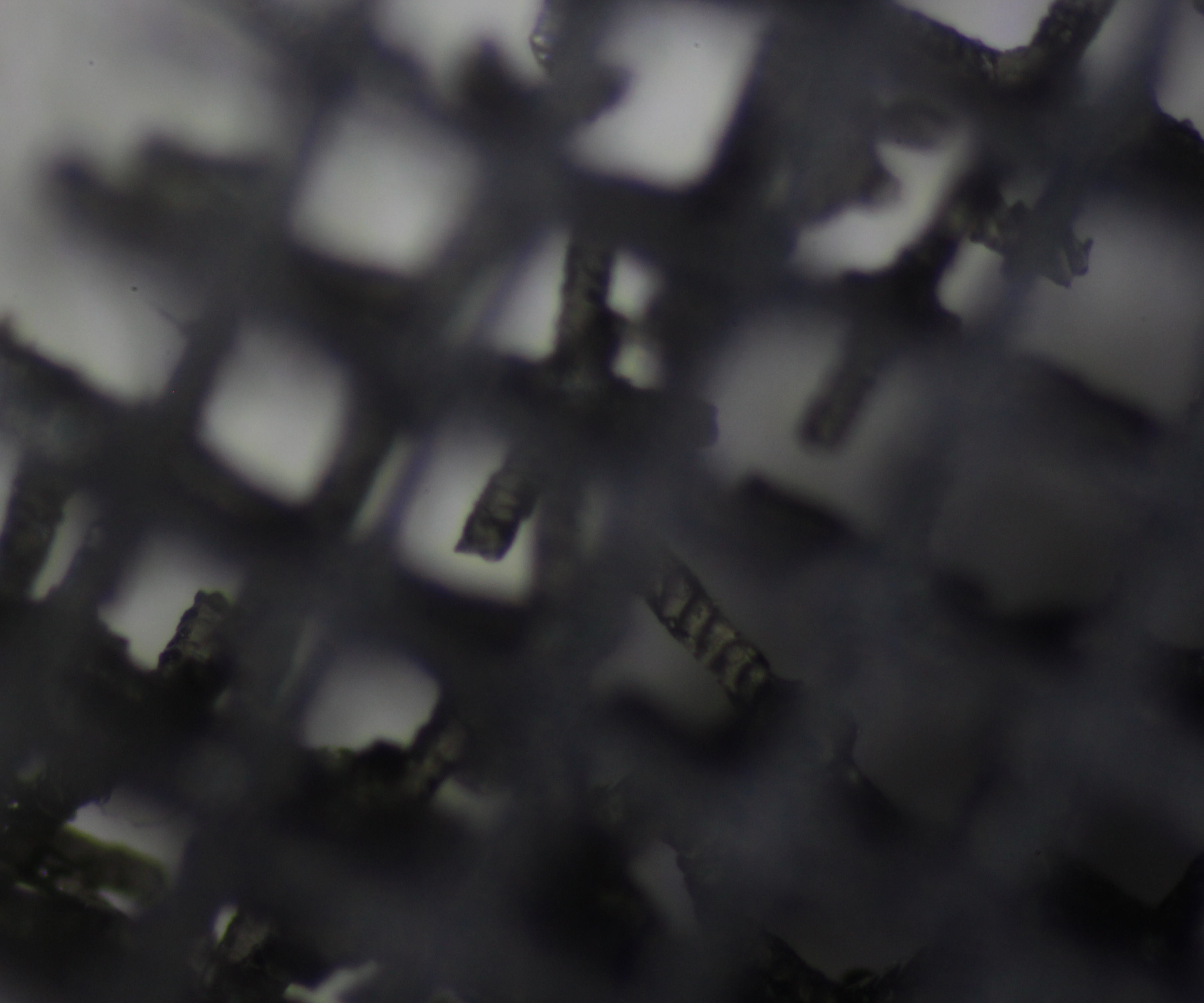

On the morning of Day 3 I was handed a fractured slide.
It was found on the deck in the evening of Day 2. I was not aware of this, so for some reason I didnt have the replacement with me. It was not fractured along a 3dprint grain, but it was fractured a little distance from the flange, so it indicated that It was not torque on the flange. What was it? I used a glue and tape to inject silicon glue into the back side of the broken slide in the morning. It worked for the first race of Day 3, but then fell out. In the middle of the two races I modified one of the old slides. I used a knife to "drill" holes in the slide where worn out pins would be pressed into. It worked just long enough to finish the day. On Day 4 I showed up with the replacement. Both the 3d printed parts lasted for 1 Race. On the way back to the dock I was handed a broken slide. We figured out what was breaking the slides. The car stop on the bottom of the track was a hard stop. When the pole came sliding down the track into its "stowed" position it was slamming! The slamming was breaking the part.
Did the part need larger flanges? maybe not. that could help.
Did it need to be stronger? I could try to print using Poly Carbonate.
Should I CNC for the next set of Races? um... YES!!!!! Time for the HAAS.
