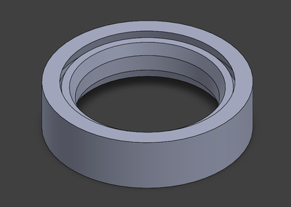

Step 2: Outer Ring
Next, I sketched the outer ring that will spin around the inner ring. I left a 0.65 mm gap between the two rings and finished the revolve. Depending on your 3D printer, you may need to adjust the gap size.

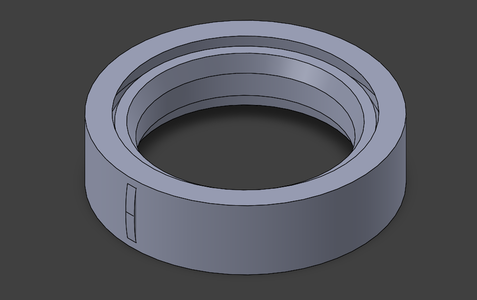

Step 3: Make a Design
Next, I added a design for the outer ring. This design will make the ring look more interesting and make it easier to spin.

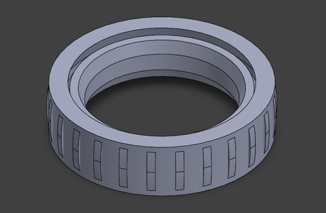

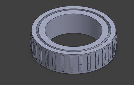

Step 4: Finishing the Pattern
I then made a circular pattern to make the design appear around the entire circumference of the ring.
We now have the ring fully modeled, and it is now ready to print. Export the file as an.STL file or whatever file type works with your printer.

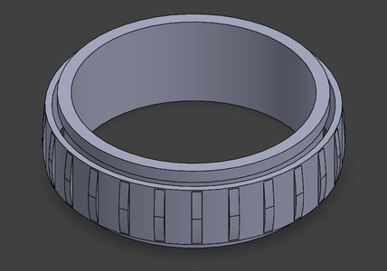

Step 6: Trial and Error (Old Designs)
My previous designs suffered from multiple problems. The last design spun very well, but there was too much space between the two rings. The inner ring fell off very easily. The design before the space between the rings was too small. It didn’t spin at all. I didn't print my first design, but it would have had the same result as the last design. Despite my errors, I eventually printed out a successful design that I was satisfied with.
