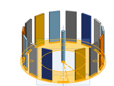

Creating the base using Onshape by creating a circle of radius of 24cm. You can choose to either laser cut it out or printing the circles and cutting through it using a saw.
Step 2: How to Create the Rectangle Strips and Circular Base
You have to create an Onshape account to create models. Then you have to create a 16cmx3cm rectangle, after you are finished then you have to create a circular base with a radius of 24 cm, small compartments for the rectangular strips will be added at the circumference of the base.
Now you will be ready with your rectangle strip and the base, there is no need to extrude the strips and place them on the base I did in the picture above for a demonstration.

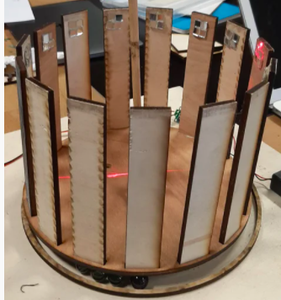

We will be adding a thin layer of wood next to a smaller piece of the circle in order to form a track. You will be doing this because we want all the marbles to stay in contact and spin the main upper base. The suggested amount of marbles range from 4-6 because it will let the complete structure rotate freely around the axis.
Do not try to add more than 6 marbles because the wooden structure will not rotate and it's due to the fact that all the marbles are clashing against each other which makes them stop.

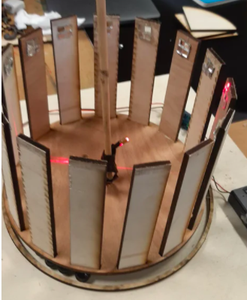

A hefty amount of time was spent on this part because we were assembling the most important component of the complete product. I made the mistake of using transparent tape which did not allow the laser to stick with the wire. The best possible suggestion is to use duct tape that sticks perfectly onto the object.
The hole we drilled at step 1 majorly affected the bigger base since we are going to pass the wires through it and then tape the laser onto the stick.
If you want to go crazy then, Go and have a try at creating a compartment for the wires underneath the massive rectangular base.

Takes a pen or a pencil and then add a dash or a line on the wooden strips. We are doing this to predict the best spot for the mirror position on the strips in order for the laser to reflect.
Step 8: Glue the Mirrors
Take a hot glue gun and apply glue at the marked spot then take four mirrors and stick them right upon the wooden strips. When the laser hits the mirror and you spin the complete structure by hand it will create different patterns in the opposite directions of the laser.
Step 9: Fix the Angle of the Laser
Use your hand to fix the angle of the laser; our goal is to find that sweet spot where the laser will not move and stay still. Therefore it will increase the chances of our laser striking the mirror instead of the wood.
