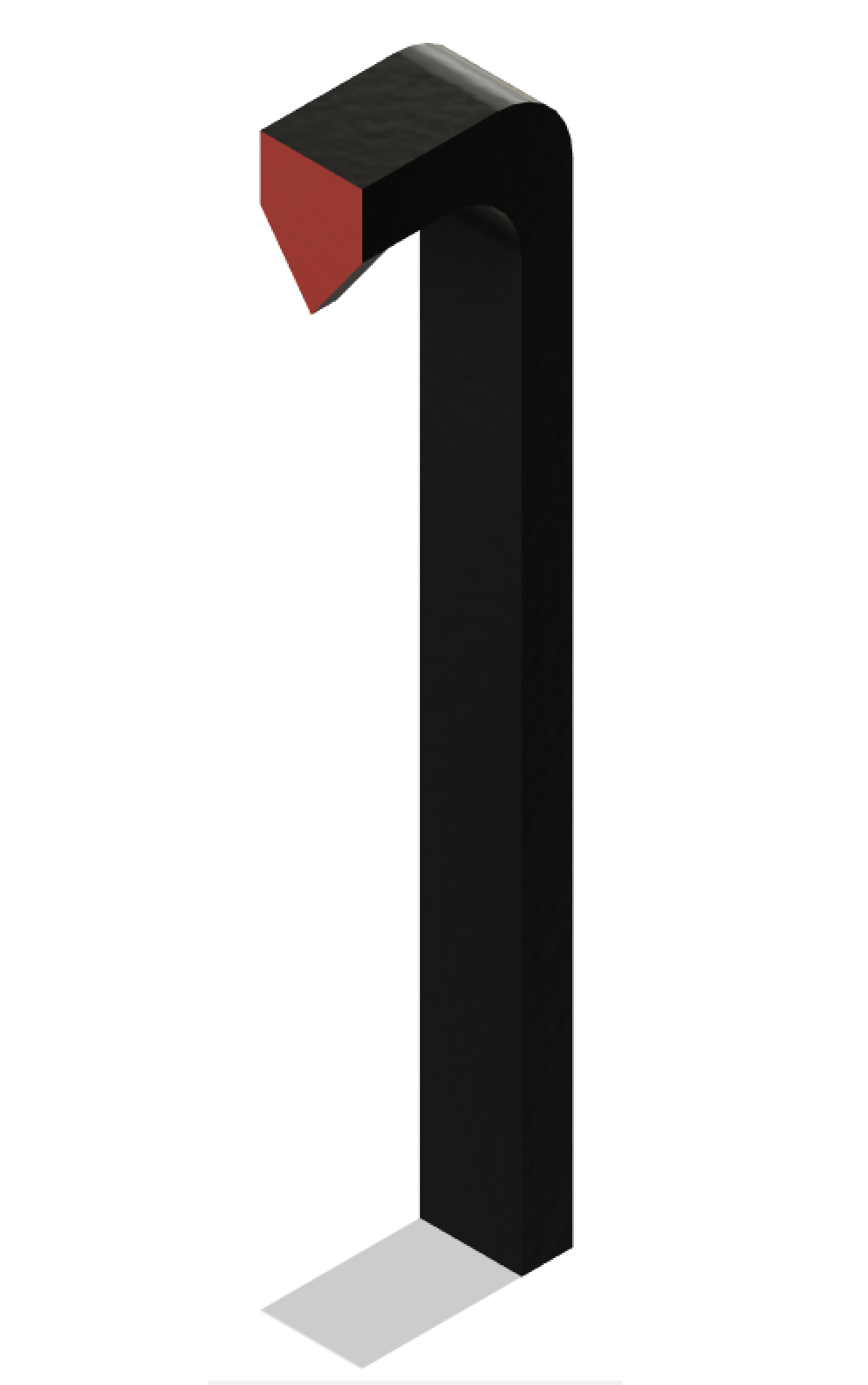

Step 2: Create Wheel Support
1) Right-click on the top of the base and go to Create Sketch
2) Create a "Center Rectangle" along the vertical axis of the base with a length of 0.80 in and a height of 0.40 in
3) Click "Sketch Dimension"
4) Click on the top of the base outline and then the top of the rectangle you just created. Input 0.20 in
5) Click "Enter"
6) Click "Finish Sketch"
7) Click "Extrude" and extrude by 8 in. Make sure the Operation is "New Body"
8) Right-click on the front of the wheel support and go to Create Sketch
9) Click "2-Point Rectangle"
10) Select the top left corner of the wheel support and input a length of 0.80 in and a height of 0.80 in
11) Click "Finish Sketch"
12) Click "Extrude" and extrude the rectangle by 1.25 in. Make sure the Operation is "Join"
13) Click "Fillet"
14) Select the outer edge where the 8 in. rectangle and the 1.25 in rectangle meet. Input 0.6 in
15) Click "OK"
16) Click "Fillet"
17) Select the inner edge where the 8 in. rectangle and the 1.25 in rectangle meet. Input 0.6 in
18) Click "OK"
19) Right-click on the front of the extruded block and go to Create Sketch
20) Click "Line"
21) Create an upside-down isosceles triangle whose bottom is shared with the rectangle's bottom edge. Input an altitude of 0.55 in and complete the triangle.
22) Click "Finish Sketch"
23) Click "Extrude" and extrude the triangle by -0.2 in. Make sure the Operation is "Join"
24) You've completed the wheel support!
