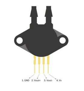

  2. MPX10DP differential pressure sensor: You could also ADP800, this sensor was not available at the time I was looking for pressure sensors, but I see now it's available on robu.in, so I'll try to get this sensor and eventually update this instructable if I see a better outcome. There's also MPX5010DP, which is a newer version of the sensor I ended up using, so you could look into that as well. It is a bit more expensive though. The sensor I got is not only cheaper compared to ADP800 and MPX5010DP, but also sort of outdated.

Now in this circuit, I used the MPX5100DP sensor, it's because it was the only sensor model present on cirkit designer. However even with my MPX10DP sensor, the connections are exactly the same. If you're using the MPX10DP sensor, then see the other pin diagram I have attached.
I have also implemented a low pass filter in order to filter out noise as much as possible, but you could experiment on your own, whatever works best for your sensor. Also it is recommended to run the sensor at 5V, now the XIAO SoCs do not have a voltage booster or 5V output like the Arduino UNO. However these sensors do work at 3.7V, just that the final analog output will not be accurate enough. Though you can fix it later in code and have custom logic for calculating the pressure at 3.7V. For this project, as this is just an exercising device, I just needed to know the pressure delta, with which we could later on build games for exercising the user's lungs.
