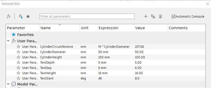

Parameters
I needed to draw the sketches first and figure things out before I could create the parameters. But it will be simpler for you to create the parameters first.
Note that I have my own naming system and use metric measurements. But you can use any names or measurement system you want. Using the name "Tube" instead of "Cylinder" would be easier to type. You can abbreviate "Diameter" to "Dia" or even just "D" without changing the function of the parameters. I just used long names for clarity in the tutorial.
Create the following parameters:
CylinderDiameter to 50 and "mm"
CylinderCircumference to the formula "PI*CylinderDiameter: and "mm" (Gasp, math and it didn't hurt)
CylinderHeight to 100 and unit "mm"
TextHeight to 5 and unit "mm"
TextGap to 1 and unit "mm" (This could also be implemented as a multiplier of the TextHeight parameter so that the gap automatically changed when the size of the text changed. It might even be a better way, but I wanted to have direct control of the spacing.)
TextDepth to 2 and unit "mm"
Slant to 1 and unit "deg" (We will replace the numerical value later with a reference to the ID of a sketch dimension)

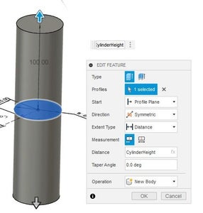

Extrude the circle sketch symmetrically using the "CylinderHeight" parameter. Once you get a better idea of how big your text will be in relation to the cylinder, you can adjust the height. And remember that you can adjust the placement of the text by using the Horizontal and Vertical fields in the dialog box

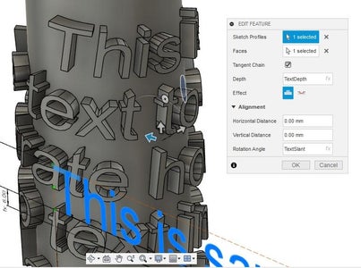

Step 5: Emboss the Text
Open the "EMBOSS" command.
Select the sketch text as the "Profile" and the curved face of the cylinder as the Faces.
In the dialog box, set the depth field of the emboss to the "TextDepth" parameter.
Set the "Rotation Angle" field to the "TextSlant" parameter.
Finish the command.

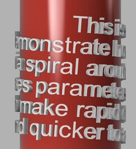

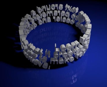

Your text should now be spiraling around the cylinder.
If it worked, open the sketch that contains the text, select the text and type a longer phrase, long enough to wrap around the cylinder several times.
Open the Parameters dialog and play. Change the value of CylinderDiameter, or TextHeight or TextGap. You will probably need to change the gap whenever you change the height of the text. NOTE: Turn off the "Automatic Compute" option in the parameter dialog to speed up regeneration if you want to make multiple changes at once.
Notice how the angle of the text changes when you change sizes of spacing. Does the angle increase or decrease? How many times it wraps all the way around the cylinder?
Change the TextDepth parameter and notice how it changes the appearance. Does the text start to distort and become difficult to read when the depth value is very large?
Remember, you can always manually set the slant angle to a value higher than the value calculated by the parameters. The calculated slant is the minimum needed to avoid touching and overlaps, so larger values should also work.
You could add a multiplier to the formula for the "TextSlant" parameter. Something like "TextSlant*1.5" to get wider spacing. That way, you can avoid overlaps using the TextSlant value as a minimum, but easily increase the slant by changing the value of the multiplier.

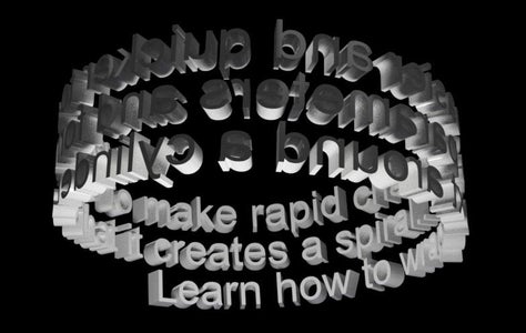

You can use a negative TextSlant angle and cause the spiral to slant in the opposite direction. Combine with the "mirror" options in the sketch's text dialog box to get the effect you desire.
Don't forget, you can also "deboss" and cut the text into the cylinder.
If you use a stencil-font and make a thin-walled cylinder, you could completely perforate the cylinder with the text.

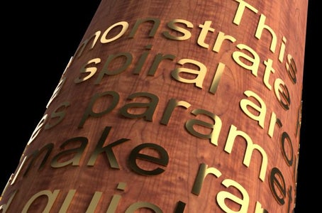

You can add a second, slightly bigger cylinder with a different color or appearance to increase visual contrast. How about brass letters on a wood column, or glowing translucent letters on a mirrored column? Maybe add some fluting on the column behind some deep text; or cut the flutes directly into the text instead.

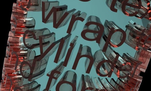

You could re-extrude the same circle using "Cut" to remove the original cylinder and turn the text into a free-floating spiral of Indvidual letters. Then, you could spiral an embossed ribbon to join the letters back together.
Or you could use the "Coil" command to create a spring shape that matches the text's spiral.
Or use the mirroring options in the sketch-text dialog to make the text read correctly from the inside of the spiral.
With some fonts, but not all, you could use a thinner of thicker version on the font and emboss to a different height to create a layered effect. Or overlay different, contrasting fonts of different depth. (Be sure to emboss onto a new cylinder each time, then use "Combine/Join" to meld all the layers together.
Using a block or reversed (negative space) font can create very interesting results.
Using Outline fonts can also create interesting effects. Some font families have the regular fonts as well as the outline version of the same font shapes. This makes it very easy to create multi0level effects.
Use dingbats to create decorative texture rollers, or a vertical font to create text that reads in a row. With a little more work, you could create two sets of text and create a candy-cane striped pole with holiday greetings.
