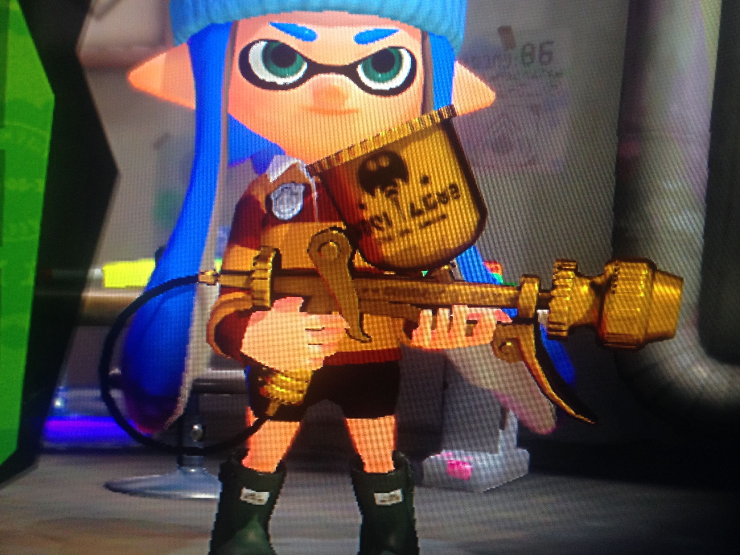

Inklings are the video game characters from the Nintendo WiiU game called Splatoon (now Splatoon 2 for the Nintendo Switch). In the game, you play as squid/kid character on a team of 4 to try and cover the ground in an arena with the most ink to win a match. Inklings use ink weapons to cover the ground and splat the opposing team which sends them back to the spawn point - allowing you more time to cover the ground. It's super fun, i highly recommend it!
For our Inkling costumes we decided on: ink weapon, ink tank, and a hat for the tentacles. Regular clothes would do for us as in the game you can buy fairly regular clothes for your outfit: sneakers, boots, t-shirts, coats, various hats, we just picked from our regular clothes for likely Inkling wear.
The INK TANK does in the game exactly as it sounds, hold your ink that supplies your ink weapons. It is a big clear cylinder that you wear like a backpack. I decided i could make several with plexiglass and craft store items.
