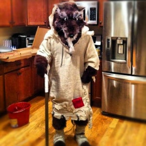

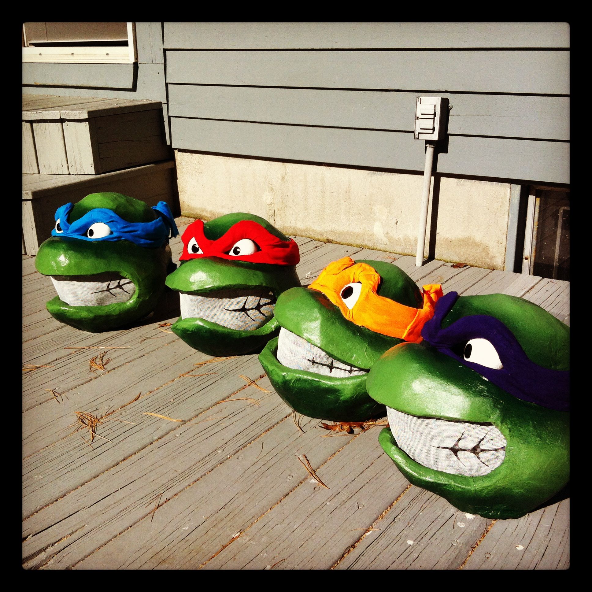

Introduction: Splinter Build
Last year I made a step by step instructable with the entire group of ninja turtles and splinter. This step by step focuses on only splinter. I took all of the photos last year during the build and since I was not focused on just splinter, my photos are pretty limited for the Master. I do not have new images to follow each step. Ill just use more text to fill the gaps.

Step 2: The Skull
To start, I googled images of splinter using several angles. I stayed away from the realistic movie images because his head is too small. I used more pics of the comic/modern cartoon images.
Cut out your chicken wire with the wire cutters. There is no set length and width to cut out because everyones head is shaped differently. I cut my wire out first to fit over my head(width) like I was wearing head phones (from bottom of the ear to bottom of my other ear.
Next cut the length of the wire almost 3X as long as my width so that I had enough wire to go from the back of my head all the way to the snout and nose and back down to the chin. Your wire should be a rectangle shape.
Using the images, mold the head to fit yours. the most important part in molding is the eyebrow ridge and divots for the eyes. First mold the width (headphones) and actually put it on your head. start molding the eyebrow ridges and eye slots where your eyes are. Later you will be cutting out a slot between the eyes for your actual vision. splinters eyes should sit just outside of your real eyes. ( its important not to back splinters eyes too wide so they sit on the sides of his head like bug eyes.) (also, be careful not to cut yourself when trying on the chicken wire mask, the wire ends you cut will be very sharp)
Once you have your eyes in place, form the snout and chin. Splinter has a slight incline in the bridge of his nose before it declines to his nose. pay close attention to his snout shape and length. You dont want splint to have a short straight snout because he will look like a kitten or a mouse. Make him kind of ugly, he lives in a sewer and is a mutant.
Last, cut out 4 rectangles separately from extra chicken wire. make 2 of them half con shaped and attach them as ears. Just spin the ends of the wire around the wire on the head like bread ties. Next, attach the 2 triangles (non con shaped) as cheeks. This will give splinters face some depth once you attach the fur. (tip: The ears should be crooked and sit on the sides of splinters head, dont make them too symmetrical.)
If I did this build over I would have attached the nose now during this step so that it was more secure once I paper mache'd. So thats would you should do. With extra wire, mold a box shape to cover the end of splinters snout. If you look at pictures of my splinter finished you can see how big to make the box. Once you make the box shape, keep some ends of the wire exposed so you can attach the nose just like you did the ears. Tie on the nose, It doesnt have to have a real secure hold now because you will mache it in place later. just make sure its straight lol.

Step 3: Paper Mache
Cover splinters skull in masking tape to give the Mache a platform to stick to.
Cut up your paper towels into 1 inch wide strips.
Mache: mix 1 part flour to 2 parts water. Add half part wood glue. This recipe does not half to be exact. the final consistency should look like egg nog. parts 1:2:1/2.
I only have an image of the turtle head mache'd but its the same process. Coat the head once then let it dry 24 hours then recoat and let dry another 24 hours.
