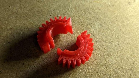

Step 1: Replicating the Gear
After trying a 3D scanning app I realized it would be much easier to just take a macro photo of the gear parts and trace the gear on the computer.

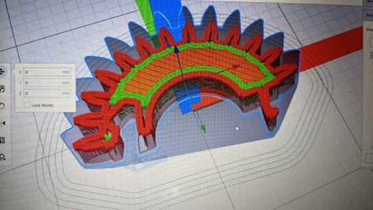

I traced one tooth and did a polar array to copy it 26 times around my hole.
The chamfer on the inner hole save you from elefant foot, that way the print will fit around a 6mm shaft without cleaning the inner hole.
If you print the inner ring raised and the teeth on a support, the teeth come out much cleaner that from the print bed. That's of course just me and my printer. The gear might come out perfectly with your settings or if you print in resin.

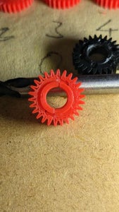

I then reglued my broken gear and took some measurements, printed the first version and compared it to the original.
I got it perfectly right by the 5th iteration and printed another one, a little beefed up, with some different settings.

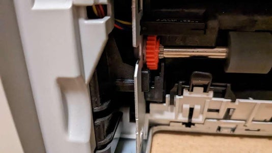

Step 3:
Why not install the gear in place? I didn't find anything on Instructables or Google so it either had not been tried or published...I am gonna change that.

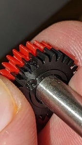

I now have an interlocking split gear that can be assembled right on the shaft.
As you can see on the picture where I had it installed, the hole was a little to small for the shaft. I took a 6mm drille an honed it out on the drillpress to make it fit and click right into place.
I still have not corrected that in my stl, so you will have to fix that or wait for me to fix it for you.

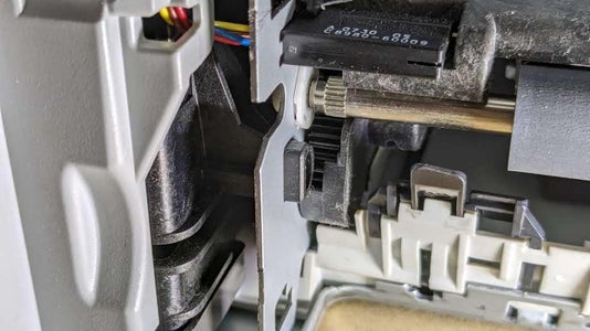

Step 4: Installing the Gear
Good light will help.
When you fix the gear to the shaft with super glue be careful with the infrared sensor above the gear. Tape it off with some painters tape to not damage it by fumes and activator.
I like to stand the printer on the side for gluing, apply a small drop and then a little activator.
The accuracy of your gear is not that important since the printer measures the paperfeed on an increment dial on the shaft so that it can even feed correctly with a wonky gear.
