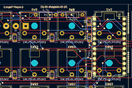

This was one of the most complicated, yet fun, parts of this build. This stems from my requirements for a mirrored design. The major low-volume PCB manufacturers require a minimum order of 5 boards. To save money, I decided to design a board that could be used for both the left and right, instead of ordering two different designs. This means that the layout must be symmetrical and the component footprints must be mirrored.
I created the 5x8 grid of the through-hole keys, all spaced 1u apart. The diodes used were surface mount, so vias were used to connect the two sides. The microcontroller board was placed and traces were routed to each row and column. Because of the mirrored design, traces were run between the two outer legs of each switch. Finally, the reset button, TRRS jack, and auxiliary connection were placed.
Due to the asymmetry of the design, the PCB needs to be cut. I used short lines of small vias to help in the cutting process. I considered adding a V-score but I didn't want to risk the right side breaking.
The entire board used two trace layers and was 98 x 150 mm. I used JLCPCB to manufacture the boards and after shipping, the total was $15.60 for 5 PCBs. This first iteration worked but has some issues that I will get into later.

When using keys 2u or bigger, stabilizers are highly recommended. Stabilizers distribute the force of a key press, allowing for equal force when pressing on the side of the key rather than the center. I included holes in the PCB for the stabilizers but mismeasured, so I needed to route them out with a Dremel tool. This was my first major flaw with the PCB. I also routed into a trace, so thin wire was used to fix this. The current build shown does not have the stabilizers installed, but I will update this when I install them.

Electrical PCB layout:
- The stabilizer holes were too small. I mismeasured and need to update this in another revision.
- The vias to split the board weren't as useful as I thought. I basically needed to saw the board in half anyway. In another revision, I would test V-score if I found it to be strong enough for the right half.
- I did not pour a ground plane which resulted in noticeable ridges along the traces. This was the result of my inexperience in PCB design.
