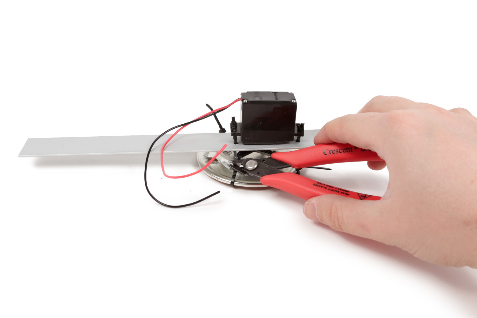

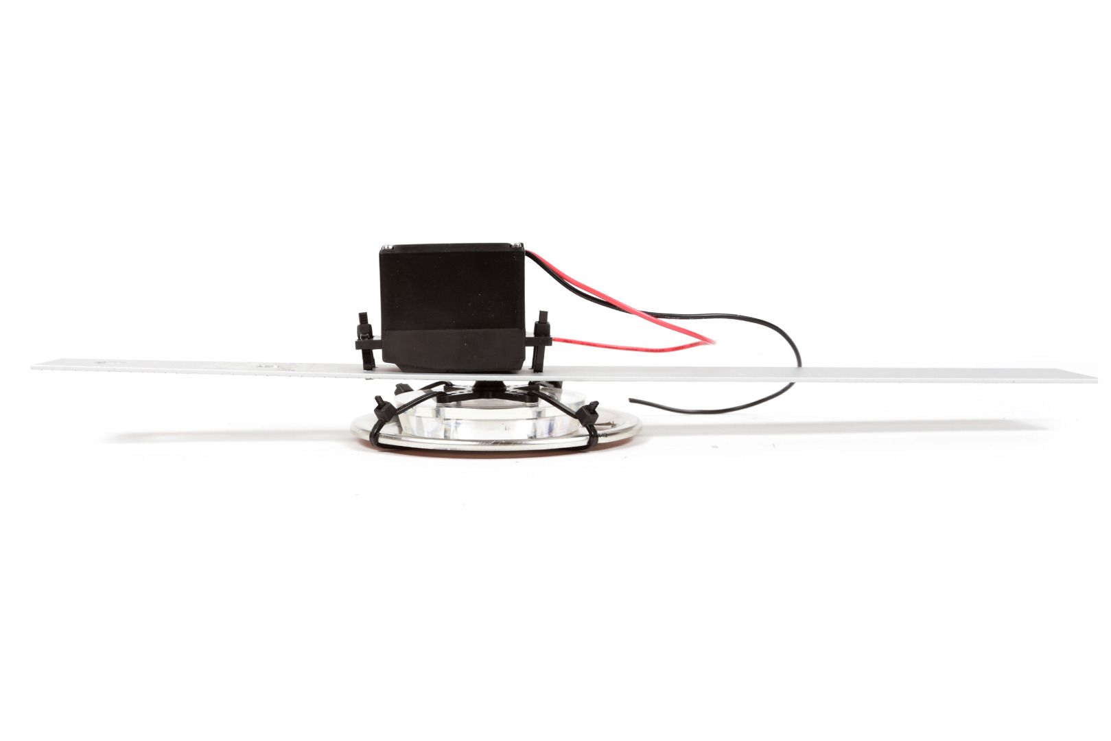

Step 13: Attach the Servo
Insert the servo's motor shaft through the 1/2" hole.
Zip tie it in place using the servo's mounting holes and the aligned holes on the ruler.
Trim away the excess zip tie tails.
Finally, firmly reattach the servo horn using its mounting screw.

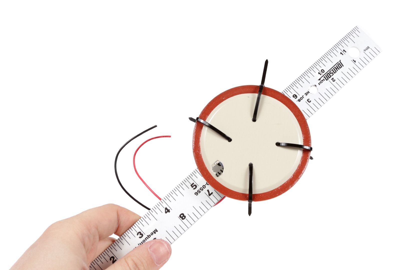

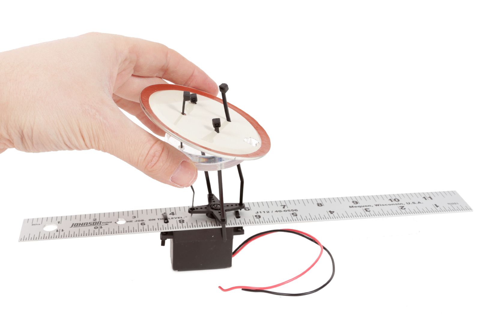

Step 14: Attach the Crank Assembly
Pass four small zip ties through the four center holes in the jar lid, and then the four holes in the plastic slider.
Next, pass the same zip ties through the four holes on the servo horn.
Pull the zip ties tight, making sure their heads are positioned on the side of the lid facing the ruler.
Trim away the excess zip tie tails and make sure the wheel can spin freely without the zip ties colliding with the ruler. If any of them strike the ruler, cut away the offending zip tie and try again.

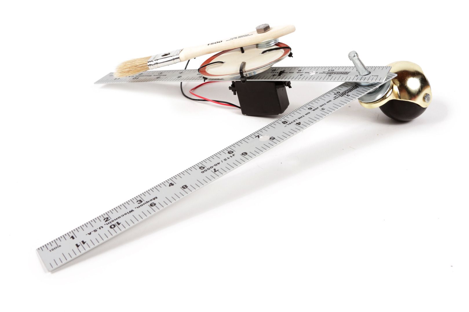

Step 15: Attach the Paintbrush
Take the paintbrush and insert a 1" bolt down through the hole in its handle. Then, slide three washers onto the bolt. These will be used to space the brush slightly above the wheel and keep it from snagging on the zip ties as it rotates.
Next, pass the end of the bolt down through the 5/16" hole in the jar lid.
Finally, lock it in place with a 5/16" lock nut. It should be tightened enough that everything is held firmly together, yet loose enough that the paintbrush can still spin around.
Thanks to the plastic furniture slider spacer, the lock but should rotate freely around without hitting the ruler. If it still collides with the ruler, you can either purchase low-profile lock nuts to replace it, or add an additional furniture slider as a spacer. Either should do the trick.

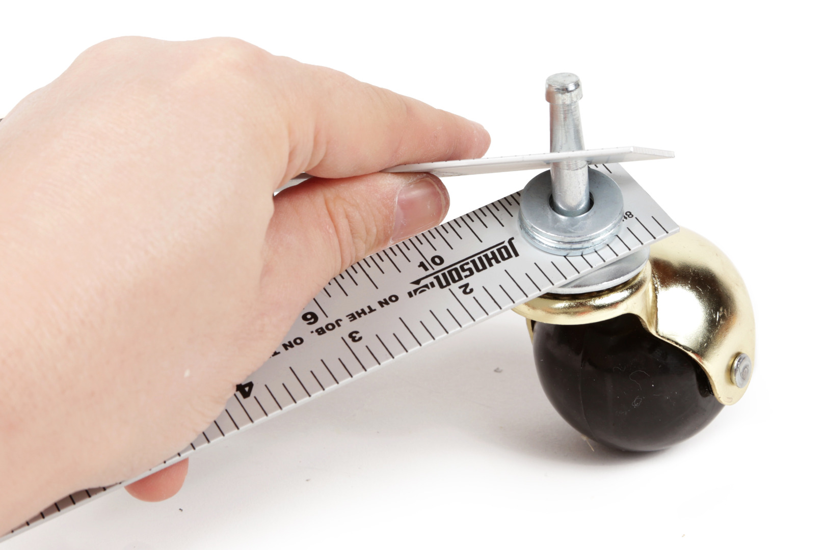

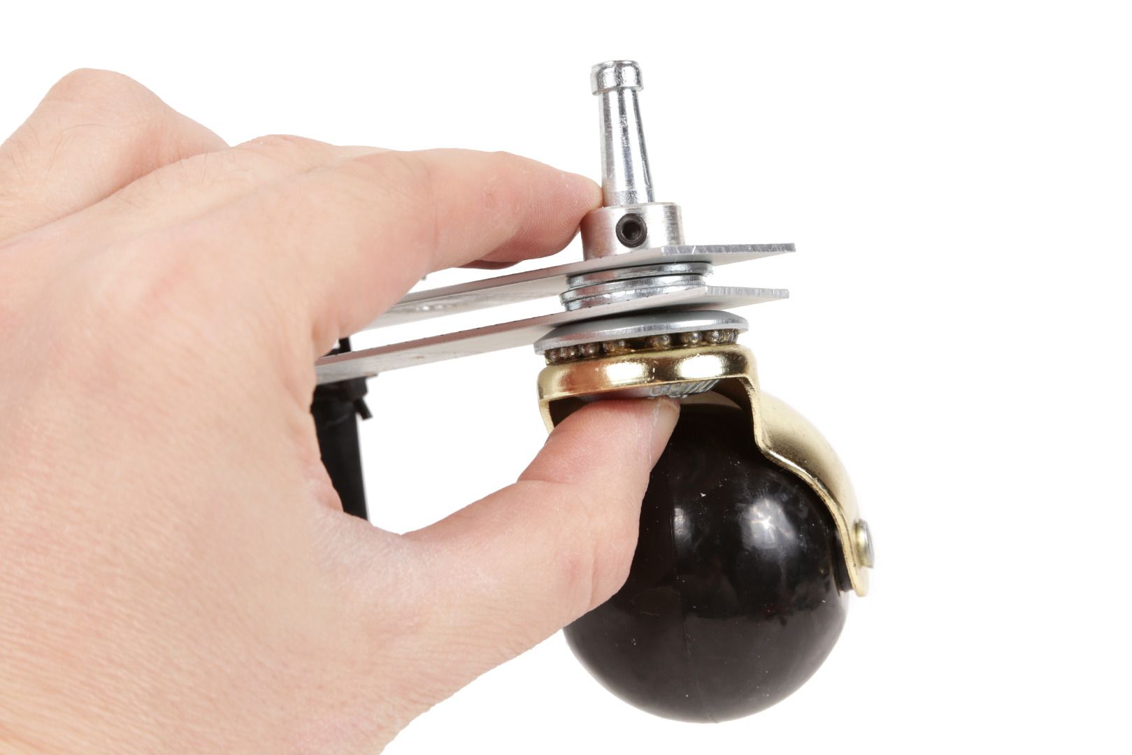

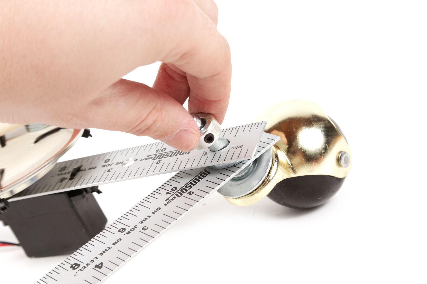

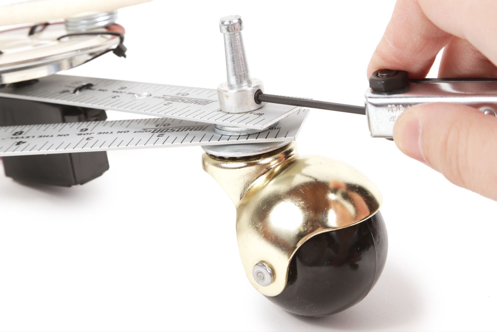

Step 16: Attach the Caster
Insert the caster's mounting shaft through the existing hole at the end of the ruler, and then slide on three 5/16" washers.
Next, slide on the other ruler onto the shaft of the caster such that the side with the paintbrush is facing up.
Finally, slide the shaft collar onto the caster's shaft. Press everything firmly together, and lock it in place by tightening the set screw using an appropriate hex wrench.
The two rulers should now pivot around the caster stem. When the connecting arm is attached to the ruler, this will cause the rulers to move in a scissor-like motion.

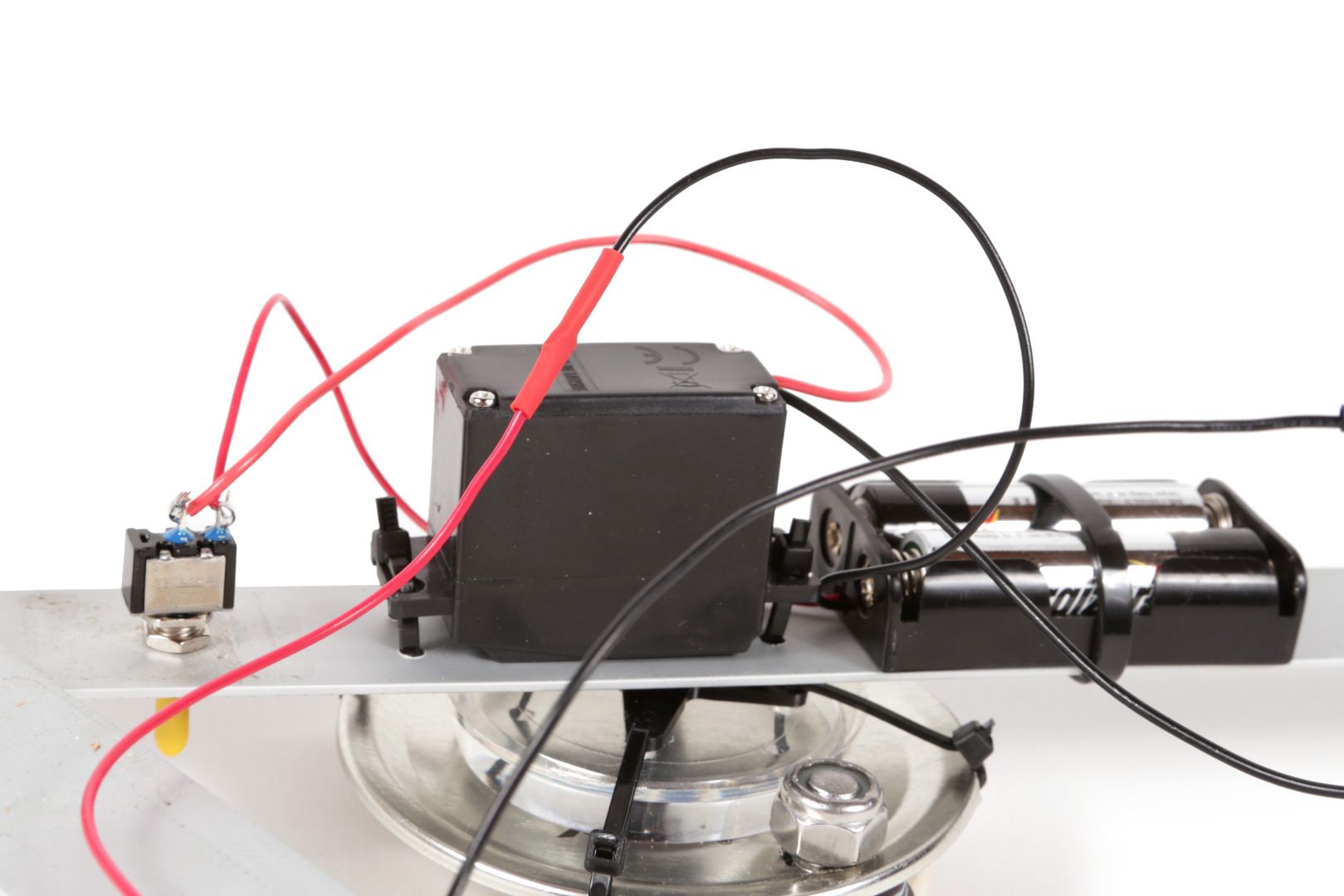

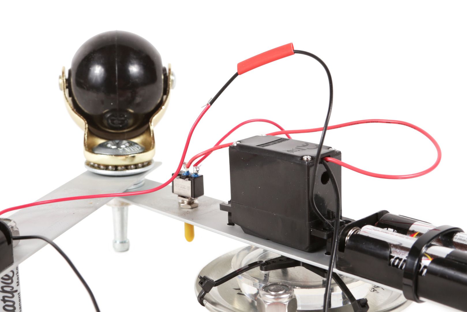

Step 21: Insert the Switch
Insert the switch into the 1/4" hole from below and fasten it firmly in place using its mounting nut.

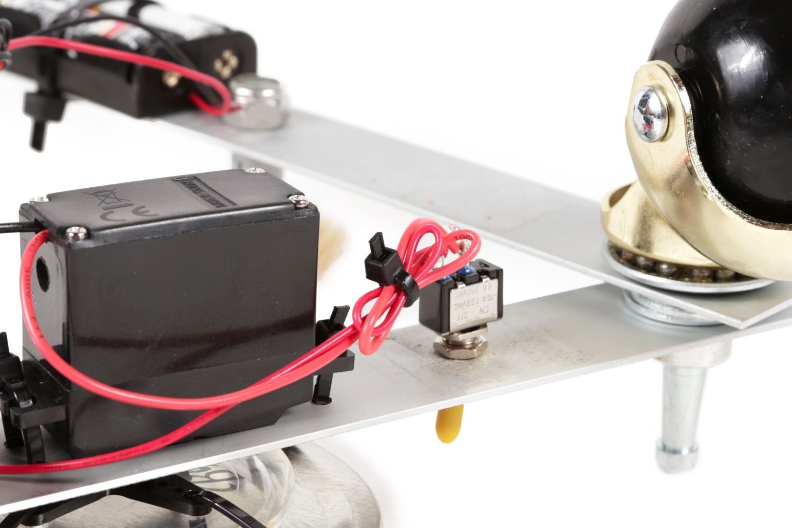

Step 22: Wire the Switch
Solder the red wire from the motor to one of the metal terminals on the underside of the switch.
Solder the red wire from the battery pack next to the motor to other terminal on the switch.

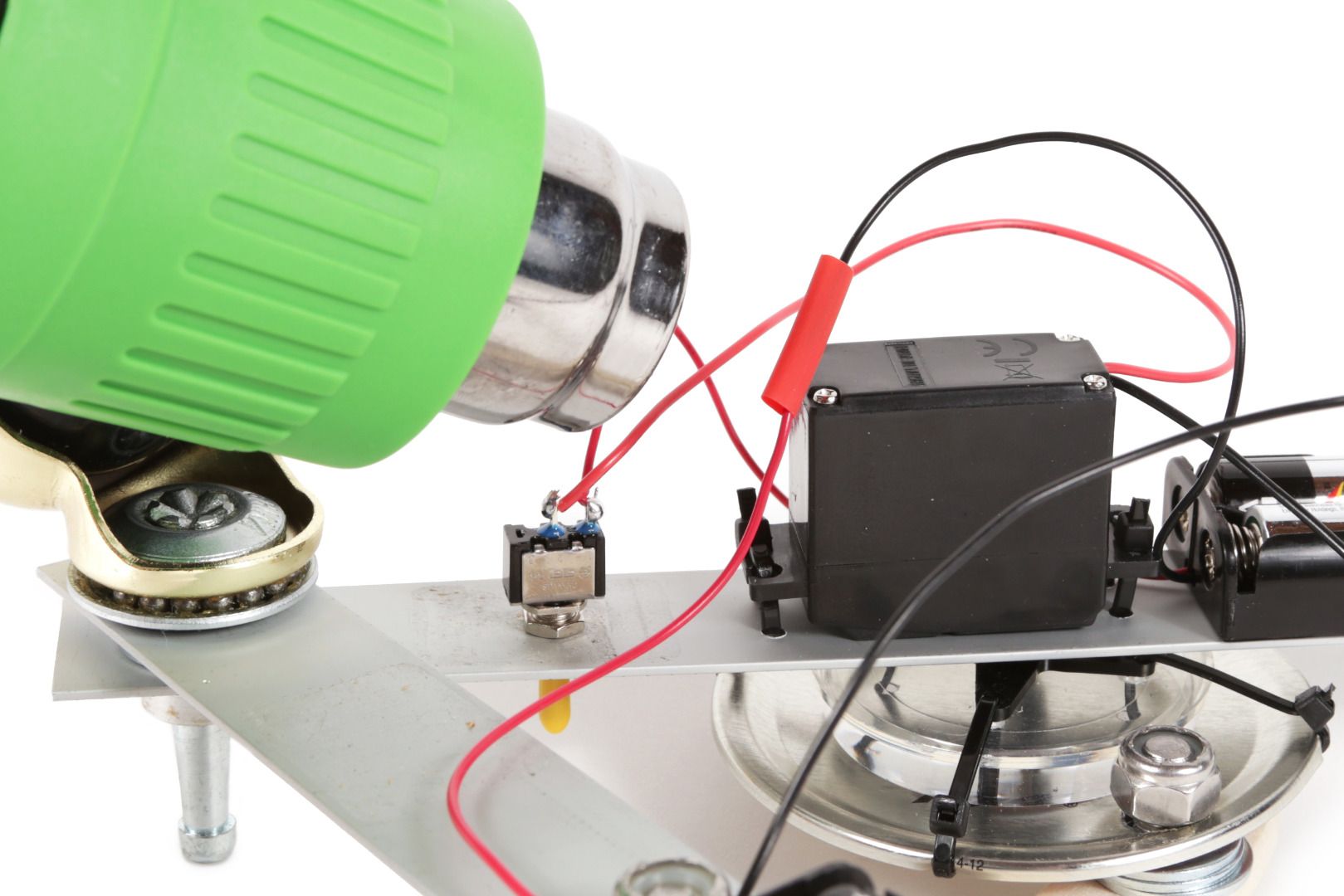

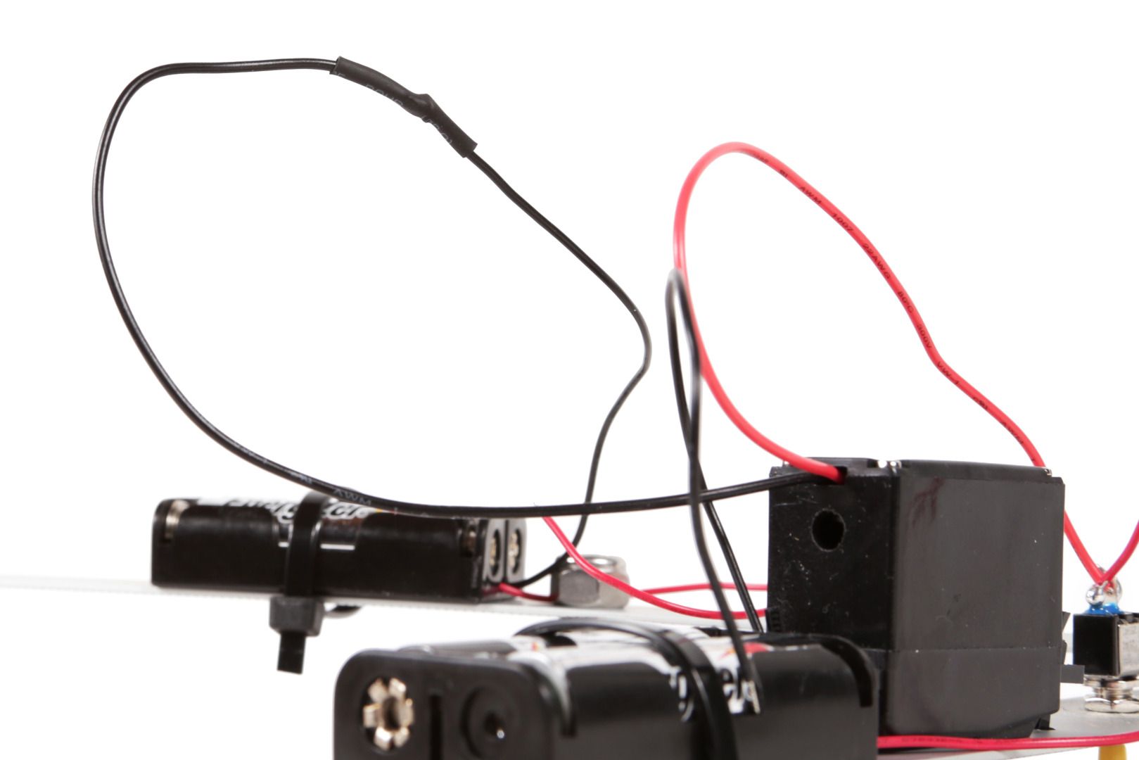

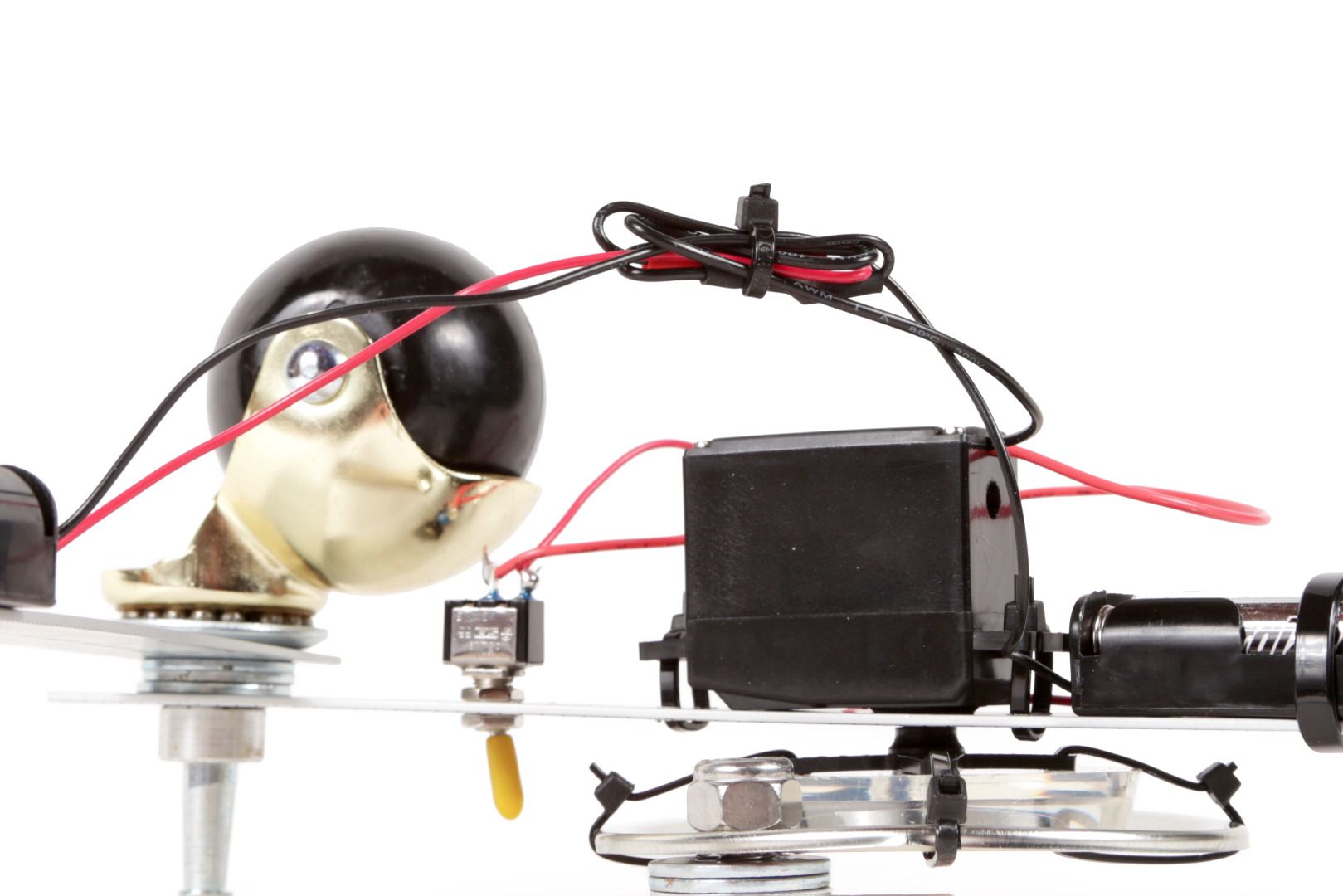

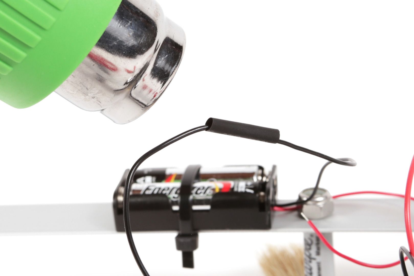

Step 23: The Remaining Wiring
Solder together the black wire from the motor to the black wire on the unused battery pack on the opposite ruler.
Insulate this connection with heat shrink tube.
Twist the remaining red and black wires from the two battery packs together. If the motor starts to spin, flip the toggle switch. It should stop, and you should be free to resume soldering the connection between the two wires.
Again, insulate this connection with shrink tube.
Finally, clean up all of the wiring with zip ties.
