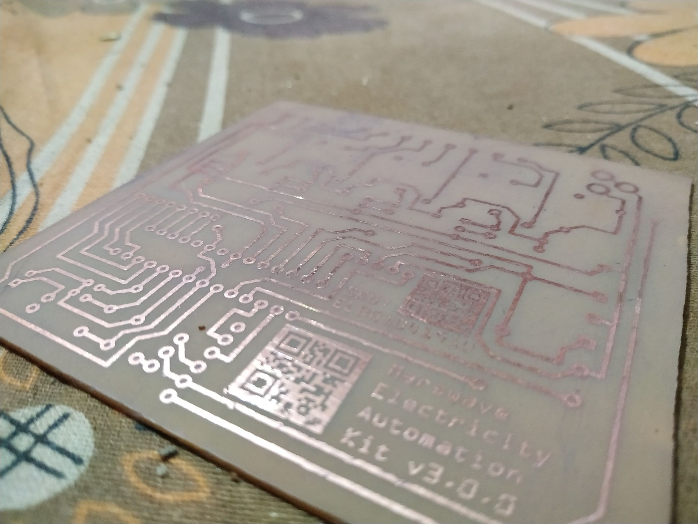

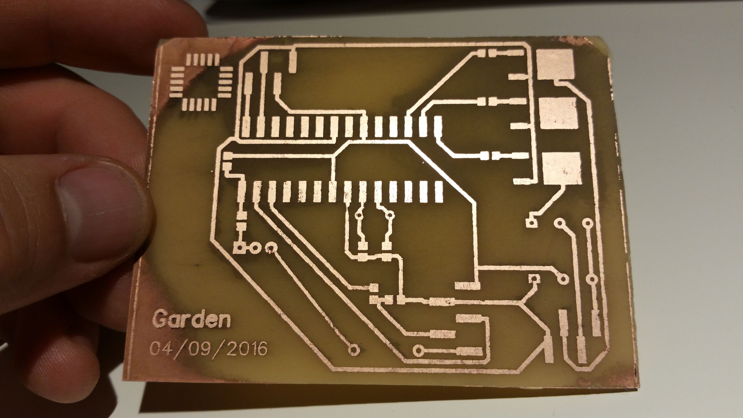

6 years ago
2016
I did my first PCB Oct. 9th using this technique w/ ferric chloride. Then I coated the copper with TInnit dissolved in water. It turned out great.
Then I realized I forgot to print the pads on this thru-hole board. So I did it again, after rerouting the tracks.
I also got this technique from pulsar fx. I didn't find your write-up here until Oct. 30th.
