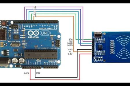

Step 2: Preparing the Arduino + RC-522
The picture above shows the wiring of the RC-522 module to the Arduino. Any Arduino will do. So, if you have an Arduino Nano available, you might consider using that. On thingiverse you can find some cases for boxing it all together. I tried one out, but its margins for printing it were too small, ending up with an unusable 3D-print.
I'm still working on a good case for that.
In order to make use of your RC-522 board, you'll have to add a library to the Arduino editor. Unfortunately, it is not a library which is managed by the Arduino editor, so you will have to add it the "old school" method of downloading it and copying it to the libraries folder. Don't forget to restart the Arduino editor to make it accessible.
The library can be found at https://github.com/miguelbalboa/rfid.
By now, you have the editor ready. It's time to upload the script to your Arduino. If you analyze the code, you will find there is an interval of 5000 milliseconds in which it is avoided printing out the same key multiple times. You can vary that interval, but if you set it too small, the same key will be shown multiple times after each other.
So, now it's time to check if this part works. The RFID's I use are standard MiFare 1Kb fobs at 13.56 MHz, which are also very cheaply available.
Open up the Serial monitor of the Arduino editor and watch the keys appear as you bring them to the RC-522 module.
