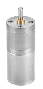

  4. 12V Brushless DC Motor

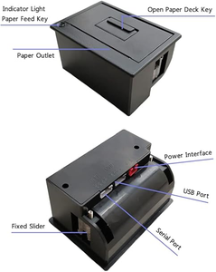

  6. TTL Thermal Printer

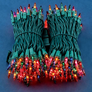

  12. Lighting Module
  13. Choose LEDS that you want!
  14. Note: We used Christmas lights that were externally controlled, so no code was written for the lighting portion of our project

Section 1: Setting Motor Driver & Motor
  1. Between the Pi and the Motor Driver (Using 4 Male to Female wires):
  2. Connect one wire from Pi’s Ground (6) to the Driver’s Ground
  3. Connect one wire from GPIO 25 (22) to ENA
  4. Connect one wire from GPIO 24 (18) to IN2
  5. Connect one wire from GPIO 23 (16) to IN1
  6. Between the Motor Driver and the Motor (Using 2 Male to Female wires):
  7. Strip the Female end of the wires
  8. Connect one wire from Out1 to one of the Motor’s pins. Solder the connection of the open wire to the Motor’s pin
  9. Connect one wire from Out2 to one of the Motor’s pins. Solder the connection of the open wire to the Motor’s pin

Section 3: Thermal Printer
  1. To Power and Connect the Thermal Printer (Using Barrel Jack Adapter and the power and data cable included with the Thermal Printer):
  2. Connect the included power cable to the Thermal Printer’s side
  3. Strip both wires on the other end of the power cable
  4. Connect the black wire to the (-) side of the Barrel Jack Adapter
  5. Connect the red wire to the (+) side of the Barrel Jack Adapter
  6. Plug in the data cable to the Thermal Printer. Connect the other end into any USB port available on the Pi

Start by screwing in the motor into the rack & pinion stand (if you haven't already). The stand should then be aligned with three holes near the back of the base. Three screws should be pushed in to lock it down to prevent the ghost that will be attached later from dismounting the entire stand
Slide the ghost onto the top of the stand, sandwiching the ghost's square hook in between the two squared shaped supports on the rack. Afterwards, put the rack up against the slot, vertically against the backing of the stand and slide the pinion in to lock it down
Note: The pinion print has a keyed hole to prevent slipping so ensure it is put in properly

Next, slide in the Printer into its slot, making sure the printable area/slot is facing upwards so it can print through the mount of the pumpkin. Ensure your Thermal Paper was been loaded in.
