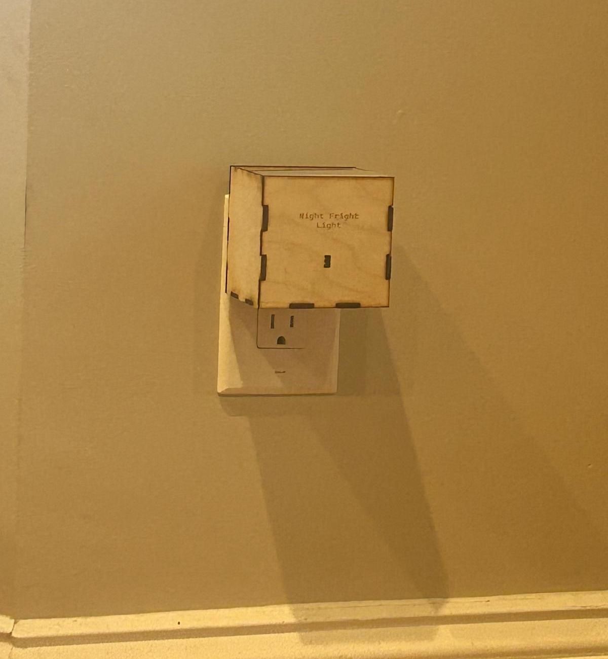

Step 3: Initial Build of the Housing
I recommend attaching the back, left panel, right panel and bottom panel to each other to provide a surface to attach the LED lights, while still being able to access everything. The above picture shows the smaller hole for the data cable to run through and the circular cut out so that the CPB is accessible even once the build is completed. I secured the panels with blue painter's tape, so that the panels would hold as I hot glued them from the inside. The same was done with the right panel (not pictured)
