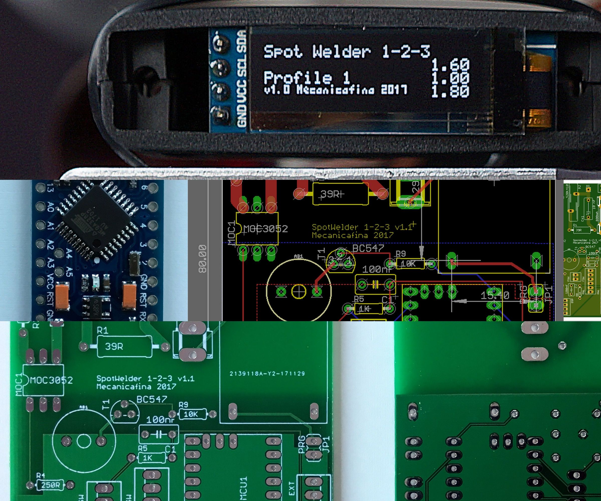

Step 5: Control Circuit
The firmware has been developed and tested using these components:
- Control Circuit:
- Arduino Pro Mini 5V 16MHz
- UI:
- Rotary encoder with push button
- 0.91” 128x32 I2C White OLED Display DIY based on SSD1306
- Momentary push button with built-in led
Of course you don’t need to use exactly these components in your build, but may have to make some code modifications if you don’t, especially if you change display interface, type, or size.
Arduino Pin Assignment:
- Input:
- Pins A1 A2 A3 to rotary encoder used to select/change profiles and parameters
- Pin 2 connected to a temporary push button that is pressed to start welding. The push button is normally mounted to a panel next to the encoder, and can be connected in parallel to a pedal switch.
- Output:
- Pins A4/A5 for I2C controlling the display.
- Pin 11 for digital output to the led, which is switched on during a welding cycle, and faded in and out during standby. There is no current limiting resistor for the led in the schematic because I used a led built into the welding button that came with a series resistor. If you use a separate led you will need to either add a resistor in series between pin 11 of the Pro Mini and pin 3 of connector J2, or solder it in series with the led on the front panel.
- Pin 12 for digital output to the mains power circuit (input to power circuit). This pin is normally LOW and will go HIGH-LOW-HIGH during a welding cycle.
After prototyping on a breadboard, I have mounted the control circuit on a self-contained proto board including a mains power supply module (HiLink HLK-5M05), the capacitor and resistors to debounce the welding button, and connectors for display, encoder, led, button, and power circuit output. The connections and components are shown in the schematic (except the mains power supply module).
There is also a connector (J3 in the schematic) for a foot switch connected in parallel to the welding button, so one can start welding either from the panel or using a foot switch, which I find way more convenient.
The J4 connector is connected to the optocoupler input of the power circuit, which is mounted on a separate proto board in the prototype.
For the connection to the display (J6 connector), I actually found it easier to use a 4 wires flat cable with two wires going to a two pin-connector (corresponding to pins 1,2 of J6), and two wires with Dupont female connectors going directly to pins A4 and A5. On A4 and A5 I soldered a two-pin male header directly on top of the Pro Mini board.
I will probably add debouncing for the encoder button as well in the final build. An improved PCB design for this project is described in a separate instructable.
Step 6: Power Circuit
WARNING: The power circuit operates at mains voltage with currents amply sufficient to kill you. If you are not experienced with mains voltage circuitry, please do not attempt to build one. At minimum, you must use an isolation transformer to do any work on mains voltage circuits.
The schematic for the power circuit is very standard for a control of an inductive load with a TRIAC. The signal from the control control circuit drives the emitter side of the MOC1 optocoupler, the detector side in turn drives the gate of the T1 triac. The triac switches the load (the MOT) via a snubber network R4/CX1.
Optocoupler. The MOC3052 is a random phase optocoupler, not the zero-crossing type. Using random-phase switching is more appropriate than zero-crossing switching for an heavy inductive load such as the MOT.
TRIAC. The T1 triac is a BTA40 rated for 40A continuous on-state current, which may seem an overkill in terms of the current drawn by the MOT in steady state. Considering that the load has a quite high inductance however, the rating we need to be concerned about is the non repetitive surge peak on-state current. This is the inrush current of the load. It will be drawn every time during the switch-on transient by the MOT, and it will be several times higher than the on-state current. The BTA40 has a non repetitive surge peak on-state current of 400A at 50 Hz and 420A at 60 Hz.
TRIAC package. One more reason to select a BTA40 is that it comes in an RD91 package with insulated tab and has male spade terminals. I don't know about you, but I rather prefer an insulated tab for power semiconductors at mains voltage. Additionally, the male spade terminals offer a solid mechanical connection that allows to keep the high current path (wires marked A in the schematic) completely off the proto or PCB board. The high current path goes via the (thicker) brown wires marked A in the picture. The brown wires are connected to the triac spade terminals via piggyback terminals that are also connected to the RC net on the board via the (thinner) blue wires. With this mounting trick the high current path is off the proto or PCB board. In principle you could do the same with soldering wires on the legs of the more common TOP3 package, but the assembly would be mechanically less reliable.
For the prototype I have mounted the triac on a small heatsink with the idea of taking some temperature measurements and possibly mounting it on a larger heatsink or even in direct contact with the metal case for the final build. I observed that the triac barely warms up, partly because it is appropriately oversized, but mainly because most power dissipation in the junction is due to conduction state switching and the triac clearly does not switch frequently in this application.
Snubber network. R4 and CX1 are the snubber network to limit the rate of change seen by the triac when the load is switched off. Don't use any capacitor you may have in your spare parts bin: CX1 must be an X-type (or better Y-type) capacitor rated for mains voltage operation.
Varistor. R3 is a varistor sized accordingly your mains voltage peak value. The schematic shows a varistor rated for 430V, which is appropriate for 240V mains voltage (careful here, the voltage rating in the varistor code is a peak value, not an RMS value). Use a varistor rated for 220V peak for a 120V mains voltage.
Component Failure. It is good practice to ask yourself what the consequences component failure would be and identify the worst scenarios. A bad thing that could happen in this circuit is the triac failing and shorting the A1/A2 terminals. If this happens the MOT would be permanently energized as long as the triac is shorted. If you were not to notice the transformer hum and would weld with the MOT permanently on you would overheat/ruin workpiece/electrodes (not nice), and possibly overheat/melt cable isolation (very bad). So it is a good idea to build in a warning for this failure condition. The easiest thing is to connect a lamp in parallel to the MOT primary. The lamp will light up when the MOT is on, and provide a visual cue that the welder is working as intended. Should the light go on and stay on, then you know it is time to pull the plug. If you have watched the video at the beginning you may have noticed a red light bulb going on and off in the background during welding. This is what that red light is.
An MOT is not a very well behaved load, but despite being initially a bit concerned about the reliability of the switching via the power circuit, I have not seen any problems.
