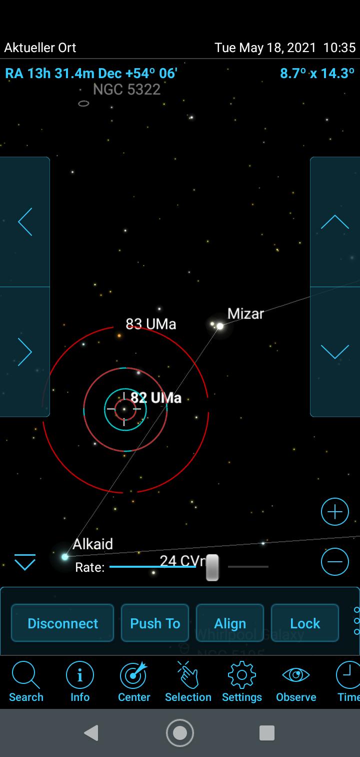

- Optional Bluetooth connection with LX200 protocol to Sky Safari, Stellarium etc.

- Optional Bluetooth connection with LX200 protocol to Sky Safari Plus (tested)

Step 13: SpotNik & Sky Safari
First of all - SpotNik has only been tested with Sky Safari Plus on an Android phone.
- Install Sky Safari Plus on your cell phone.
- Integrate HC-05 bluetooth module into SpotNik.
- Turn on the Bluetooth connection between the cell phone and SpotNik.
- Pair cell phone and SpotNik (HC-05 with key "1234")
- Open Sky Safari Plus
- Under Settings / Scope / Setup select "Meade LX200 Classic", "Equatorial GoTo" or "Equatorial PushTo" and "Connect via bluetooth".
- Click on telescope in the main screen - press button "connect" - wait for the connection to be established (this may take a minute)
- Then you can select a reference star in SpotNik and the Sky Safari should align to this position.
- If you have selected a GoTo telescope you can also select targets in Sky Safari and send them via "GoTo" to Spotnik.
- If you are in the menu item "Align" or in the display "Curr" the reference position will be adjusted to the coordinates.
- In all other cases the target position will be adjusted.
