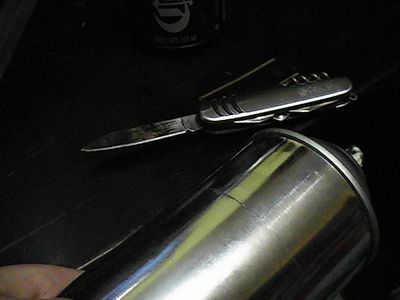

grab that useless knife...
this is the knife i use to cut through plastics, i bet we all have at some point heated a blade for this purpose.... i just gave it a few strokes with a coarse sharpening stone and i got a coarse cutting edge on it wich is what we need (a serrated blade might also work id look for one with small teeth)
I AM NOT RESPONSIBLE FOR ANY INJURIES OR DAMAGE TO PROPERTY OF ANY KIND
FOLLOW THESE STEPS AT YOUR OWN RISK AND USE COMMON SENSE IF YOU HAVE ANY
start trying to cut through the line but do not put so much pressure on it cuz you will dent the can (once you have no pressure inside anyway)
IMPORTANT! FIRST concentrate on one spot , dont move your blade along the line just yet, slowly but firmly notice how the blade starts to take metal away on that spot UNTIL some air starts to come out, IF you do this with much force you might make a big hole and the leak of air will be bigger and LOUDER so, do this slowly, AND AFTER YOU SEE AND HEAR A LEAK LET IT VENT OUT, keep the hole facing upwards so you dont get paint all over your project
CAUTION: this might be a flammable gas (im actually 99% sure it will be) so keep away from any ignition source
when the can is done de-pressurizing (youll notice it gets really cool while it does this XD ) keep cutting through the line, use the edges of the last spot you cut through and continue from there, its a bit easier that way, be careful not to make too may dents (we'll take care of small dents later on)

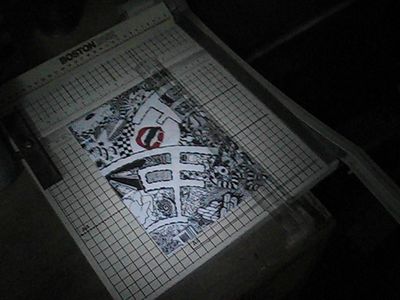

Measure the label, my label was 8.5" wide and 6" tall, take into account the overlapped edge
use any image editing software you want, just make sure it has rulers on screen and adjust as necessary... i scanned one of my drawings and resized it
i decided to cut my image a bit short on the cap end and a bit longer on the body end so it wouldn't get too messed up when closing it, it was a mistake! not only does it get messed up but its also harder to close it and take care of the design at the same time
next time im going to cut it the exact distance on each side...

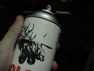

to place your label on the can you will need clear tape and some paper glue
we will be using the line where the sheet metal was joined as a guide for this step
place the body part of your label in place , to make sure its aligned properly check that it can go all around the bottom edge staying inside as shown in the second picture, and also align it as best a s possible with the line i mentioned before
hold it with some tape (picture 1)
repeat process for the top part
after you have secured both parts of your label with tape, put some paper glue on the overlapping side of your design and ... um just glue it together, i dont think i need to explain much here
