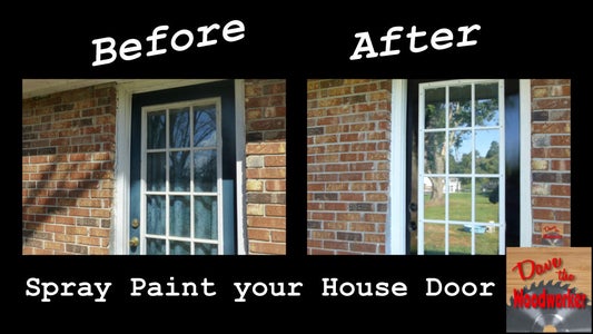

Spray Paint a House Door for Under 10 Bucks
Introduction: Spray Paint a House Door for Under 10 Bucks
About: Hi my name is David, I like to make things out of Wood, also like to take things apart and fixed them.
Today I will show you all how I sprayed painted my Back door, made it look like new.

Now take a look at your door, it looks like a brand new one. Thanks for checking out my Instructable, I hope this helps someone.
