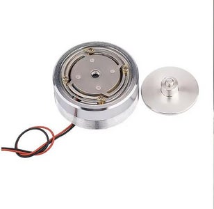

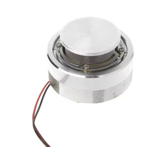

-Audio Exciter (40mm 15W 4 Ohm)

For the exciter, I first deattached the main piece and drilled a hole of around 2.5mm as close to the perimetrer as possible (this way it will be easier when connecting the spring).

Step 4: Mounting the Exciter to Our Surface
I'd say this is one of the most crucial steps in this project, since not mounting the exciter propperly and, most importantly, not cushioning/isolating it well (as it was my case), can have a big impact in the sound quality.
In my case, I tried using the packaging foam shown in the picture to try dumpening the vibrations coming from the exciter. However, I didn't take into consideration that I was actually attaching it to the cardboard in the back, so at the end of the day, I had an membrane-like structure giving me sound that transfered into the rest of the project and, inevitably, into the piezo mic.
Giving my situation, I'd suggest experimenting with other isolating methods and find some better solution than I did. In the future, I'll probably try suspending it so I can avoid as many not wanted sound as possible.
