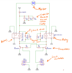

Step 6: Electric Circuitry
The electric circuit is based on an RS Latch circuit. The limit switches on the either side change the direction of the motor.
When the forward limit switch is hit, the circuit lathes the motor in reverse mode, and when the reverse limit switch is hit, the motor enters the forward mode. This gives the system the oscillating nature which allows the machine to churn out springs continuously.
The circuit diagram of the system is shown in the image of this step. The relays used here were 12V ones.
When the machine is powered on, one of the sides of the RS latch turns on randomly. This sets the machine in motion either in forward or reverse direction. Once the machine is in motion and hits the limit switch on the either side, the motion is reversed the machine continues this back and forth cycle indefinitely.
The circuit also has a capacitor bank. This bank ensures that there is enough power available to latch the relays at all times. This is especially important when the motor switches direction. This circuit does not have a soft start of any sort. Hence, when the motor voltage is flipped, the current inrush is huge. This will definitely cause the supply voltage to collapse and more so if the system is powered by a switching mode power supply.
