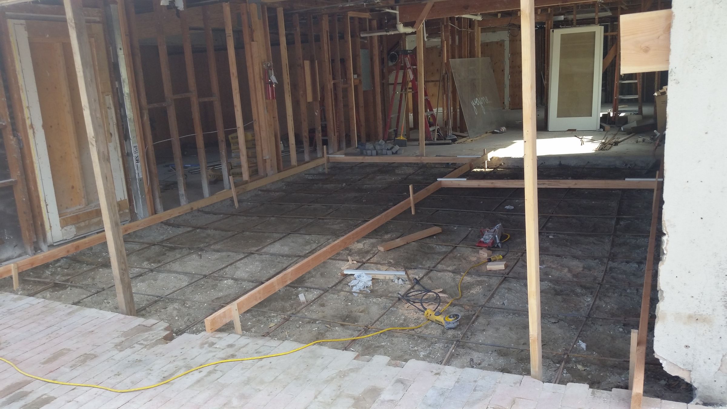

Background:
*New residential home
* No current sprinkler system
*Sprinkler system will go to three planters.
*Sprinkler system will be covered by a concrete patio
* Note: Contractors that installed water pipe did not install properly. You can notice our PVC pipe is angled due to the already installed water system.
Background:
