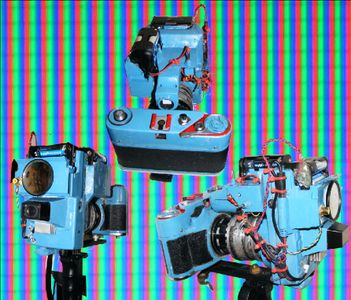

Step 1: Required Parts and Tools to Go Sprokettey Through a M49 Lens.
metal leaf shutter from waterdamaged praktica from my camera parts box
lens mount m42 from camera parts box
rangefinder camera fed5 (also damaged)
viewfinder from kodak disposable camera
a small spring (from my parts box)
push button
0.5mm aluminium sheet
solid wire 0.4mm
bondo
paint
contact adhesive
epoxy glue
craft foam sheet 2mm
scrap plastic 1.5mm (from my ps3 case)
self adhesive felt

Step 2: Get a Metal Shutter From Busted Camera
a metal leaf shutter from a broken ,blah blah blah, left in a parts box.
i was originally going to use a solenoid to operate it, (type from model railway points changer)
i ended up just using a lever.as a reliable option.i used the lever from the cameras original self-timer ,so that the design stays contiguous .
i also reduced the shutter to one side, only the top set of leaves, to make it simple , also the rust was jamming one side.

Step 6: Epoxy the Rag Tag Shutter Assembely to the Front.
all the bits are tied together with wire, to keep them in place ,while initial glueing , its all left there as i fill over it with a more solid material. all the time trying to keep the lens mount front edge 45.46mm away from the film pressure plate.
Step 7: Wedging in a Nice Spring, Then Start Filling.
I wanted a nice snappy spring,i made a selection from the spring box(parts box) hooked it around the shutter lever, all tied in with the five minute rule then lots of filler keeps the wires from moving
also fill any holes in the top and bottom that might let light in where it aint supposed to be.

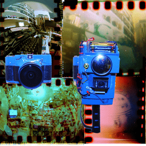

Step 18: Shoot Some Sprockets!
add some film and and close the back and take sprocketty pictures with any lens you please.mostly i took pictures with a zenitar fisheye lens (180 wide diagonally) when the lens has more film to project onto the effects are nice,

Step 22: Communication and Spreading the 6v About a Bit.
have to attach wires to the contacts of a 3.5mm jack from a power supply , this will be used to put a video signal into the tv
the tv and viewfinder require 6v. these videos im testing if they are happy sharing power supply. i later upgrade to 2 lots of 4 aa batterys to have 6v at a higher amperage.
Step 23: Glueing and Maching Together.
did the initial framework with scrap plastic parts put together with poly-cement. (weak) later used bondo to sure it up.
more info on the viewfinder via my back to front camera1 step 7
opening the tv so i can chop at the case without breaking the insides. marking the position for the lens hood, (acts as spacer for lens and screen)
grinding the tv case so the hood will sit flush, i got something in my eye whilst doing this,i had to keep going as i have no editing software.
epoxying the lens hood on, (heat activated strong stuff)
Step 24: Preview of the Prieview Ooh Woo Moo Iew
made so i could tell how bright the screen is .(but i cannot get a perpendicular view to the screen.)
i added the prism from the rangefinder to bend the light 90 degrees from the screen.
Step 25: Sticking the Wires Together.
the basics of the wires together , i will shorten dangley bits later and wrap in zip ties. oh and the reversing cameras been glued to the front, (it runs on 12v so thats a gap in the top for 8aa batterys.)
i added a switch to the video part of the camera so it can switch to an external input. or output its video feed.
the video part has a wire for mirror image so i put a switch on that as well.
i also add paint here and there as i decide what to do and how it will look.
Step 26: Make the Camera Bit Look Intergrated
looks better then seeing the mount, i use tape to mask where i dont want the gunk, i later realised id put it on upside down, so while fixing that i added a heat sync.
Step 27: More 6v, and a Nicer Video Input/output Socket.
the batterys drained quickly to the tv and viewfinder, i used the original battery space enlarged and extended to hold the 8aa , two lots of 4 in parallel.
i also added a phono socket , so it can output a video feed or record (stills) an incoming feed.
Step 28: Ergonomic Consideration.
,added a bolt on handel so it has better balence when in use.
also felt that the way the apparatus stands without the handel attached saw not good enougth, so i found a better shaped piece of metal to attach under the camera body , and made a solid lump of bodyfiller attached to the support structure beneath the tv, it approximately follows the shape of the tv, and has a nice flat base.
Step 29: Some Test Shots.
notes made during the test rolls
1 i forgot to take the handle with me which made holding it difficult.
solution remember handle
2 getting the screen brightness correct via the prism is near impossible.
solution calibrate before then tape over control
3 underexposed, i was using a short second exposure time.
solution use a long second
4 images have a washed appearance , probable cause stray-light
solution add some tape around screen to reduce white frame, also put some tape over most of prism
5 focus could be better.
solution recalibrate
6 heavy grain, 400asa fuji film
solution use 200 asa
7 the brightness difference between the top and bottom of the image is a lot.due to the tint viewing angle of the primitive screen , i cannot fix this.
