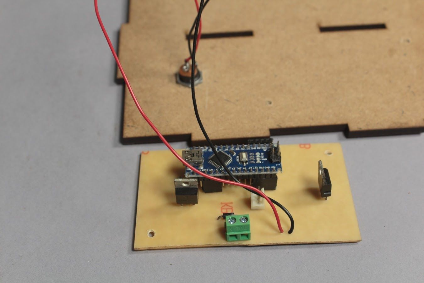

A 1x Scale printable PCB as well as the board view and schematic is available in the GitHub repository.
The repository also contains an A4 size PDF which contains multiple PCB's on a single page. This can be used to make multiple PCB's at a time for mass production
Solder all the components according to the given Schematics.

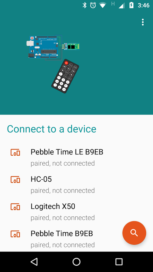

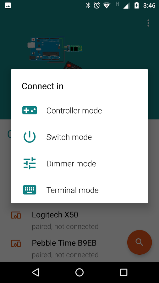

Smartphone App & Bluetooth Configuration
The HC-05 Bluetooth module is the intermediate block between the Smartphone & Arduino. It uses Serial Communication to send data from the Smartphone to the Arduino & acts as a Remote Control.
The app transmits the value '48' or '49' which represent 'ON' & 'OFF' respectively. The pump can hence be controlled wirelessly.
Simply open the app, scan for discoverable devices & pair with the HC-05 module. then click on 'Switch Mode' and toggle the onscreen button.
The app is available at Bluetooth App

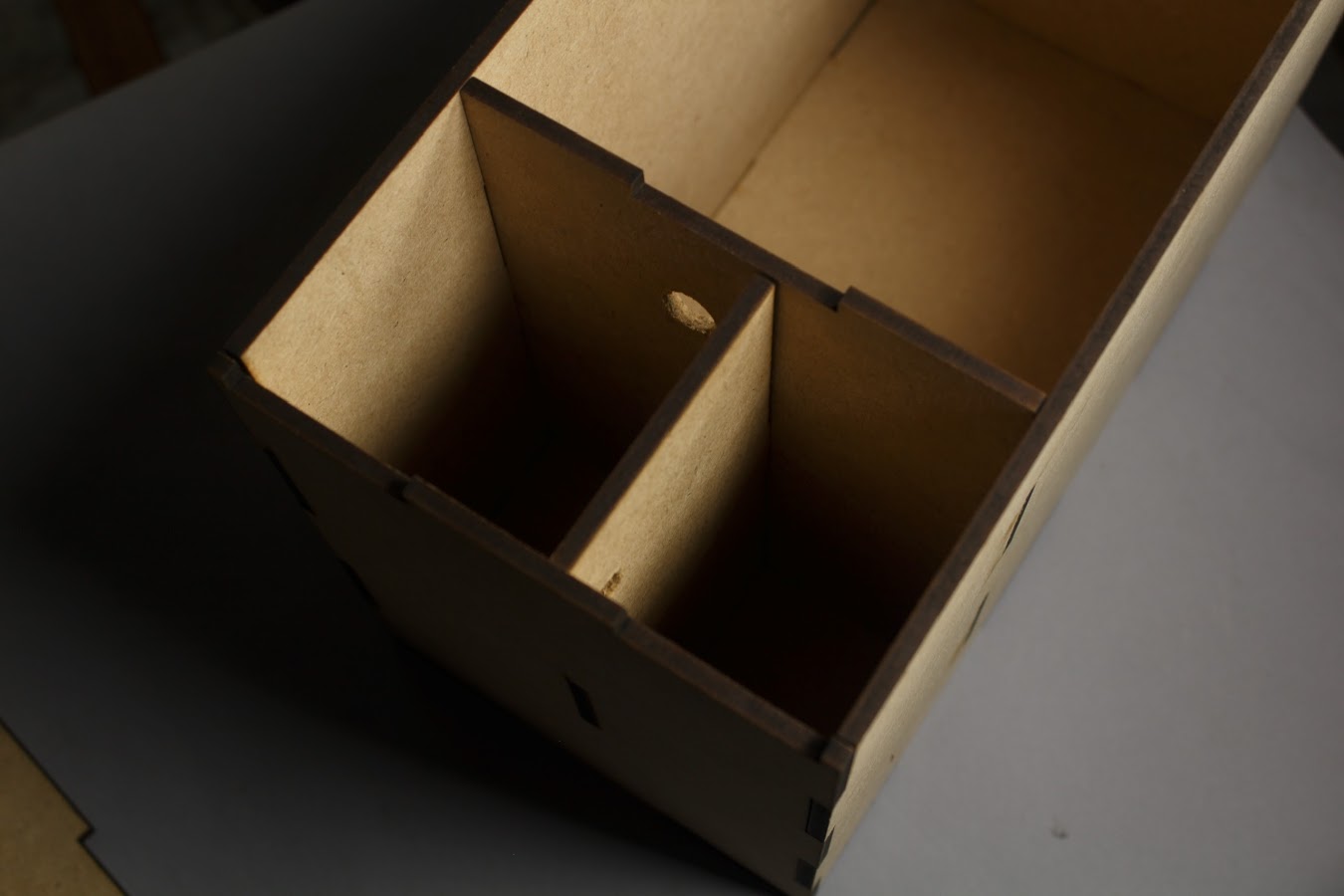

Step 4: Mechanical Design

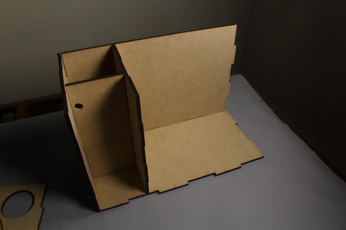

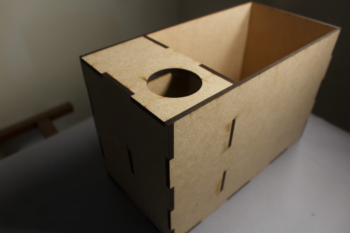

The main body of Sprout is a 30cm X 15cm X 19cm Box made out of MDF.
All Mechanical Design steps have been clearly demonstrated in the video attached at the start of the Instructable. You can also check it out at Sprout: Video/Mechanical Design
The box is divided into two sections:
- The larger section contains the Soil & Plants
- The smaller section is further divided into two more sections such that one section contains the Circuit Board while the other contains the Water Reservoir.
The water reservoir is a 500ml plastic bottle.

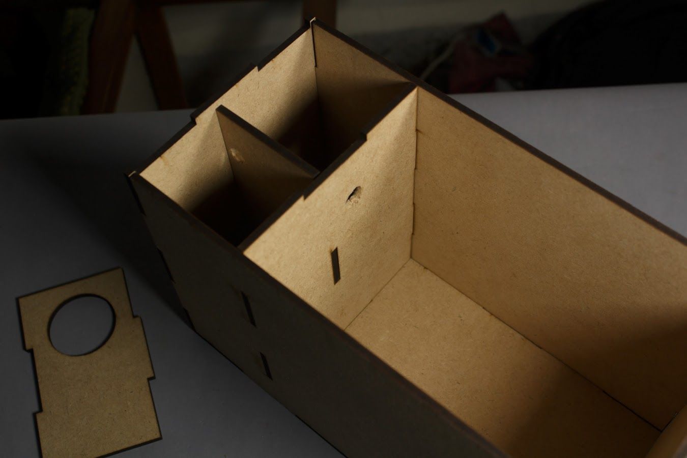

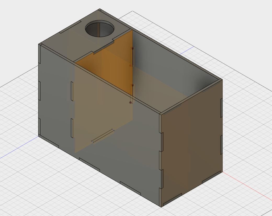

The MDF box has 8 separate interlocking faces which can be laser cut and slotted into each other.
The Laser Cutting files, Fusion 360 Design file (3D Design file), isometric as well as orthogonal views of each face can be found at Sprout: GitHub/Mechanical Design
You can also find editable Illustrator files in the GitHub repository which can be modified to your specific requirements/dimensions and then can be laser cut.

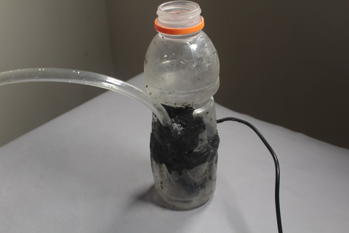

The water reservoir is a 500ml plastic bottle. A typical 500ml plastic Soda bottle can be used for this.
The maximum diameter of the bottle should be 74mm. The maximum diameter of the cap of the bottle should be 50mm. The maximum height from the base of the bottle to the lowest part of the cap should be 18.5 cm.

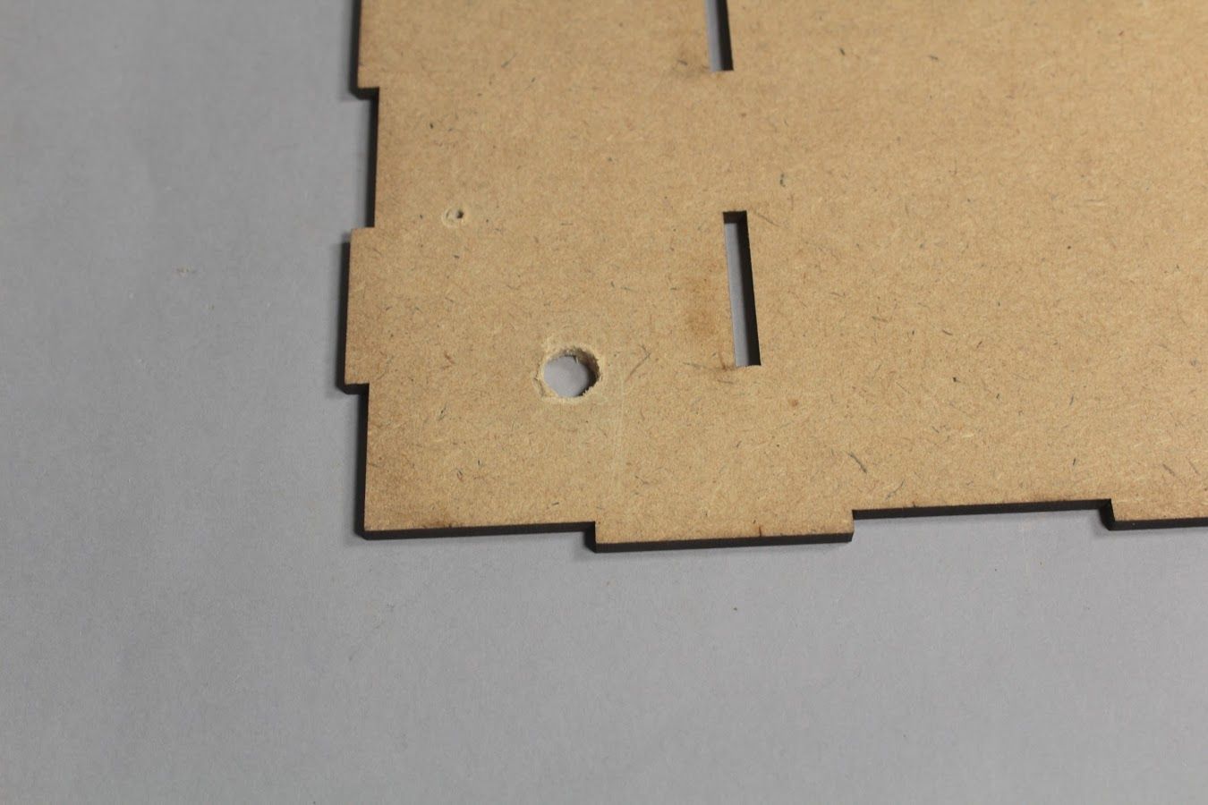

The bottle must be cut about 50mm above its base so that the pump can be placed within it. Holes must be cut into the bottle such that the Outlet Pipe and Power wires can be fed through the bottle.
Once the Outlet Pipe and wires have been taken out through their respective holes, the bottle can be sealed again. To seal the bottle we must use an Epoxy Compound which will harden within a few hours. This will prevent any water from leaking out.
The water can be refilled from the top of the bottle by simply opening its cap.

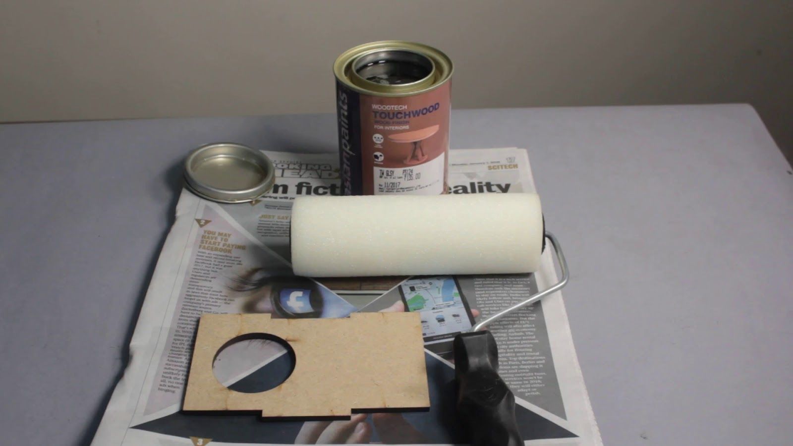

Once you have successfully laser cut the 8 different faces of the box, Apply several coats of a high-quality wood varnish to each side of each face.This makes it highly water repellant & makes it resistant to moisture & humidity.

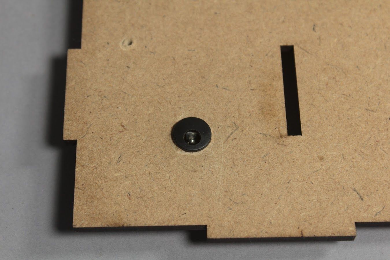

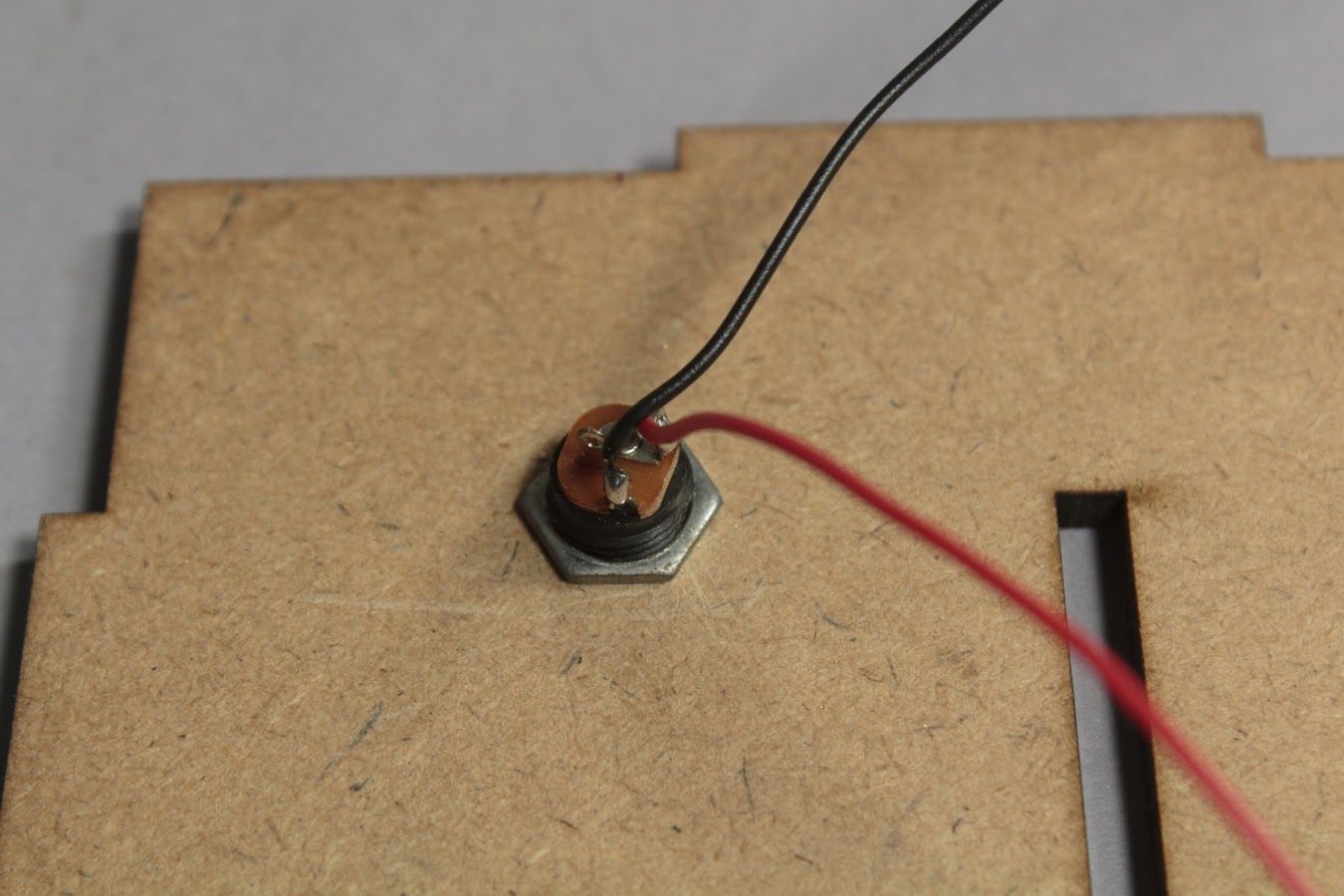

Mount the Power Jack on the Back Plate too & connect it to the Circuit Board.

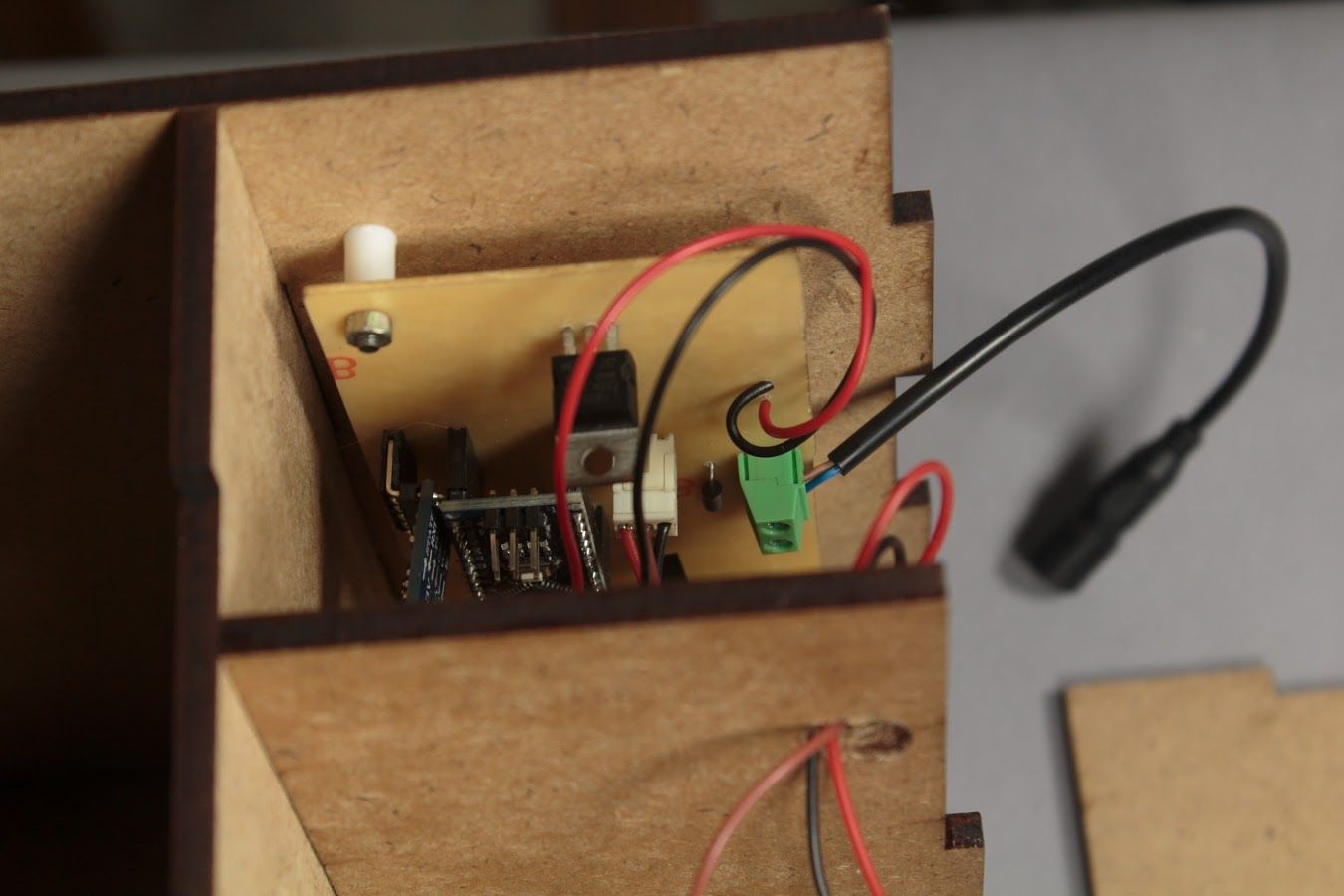

Mount the Circuit Board on the Back Plate of the Box such that it fits within their respective section.
Pull the Pump Outlet Pipe through the given holes such that it reaches the Plant soil section. Do the same for the Moisture Sensor wires.
Don't forget to connect the Water Pump to the Circuit Board as shown in the Schematic

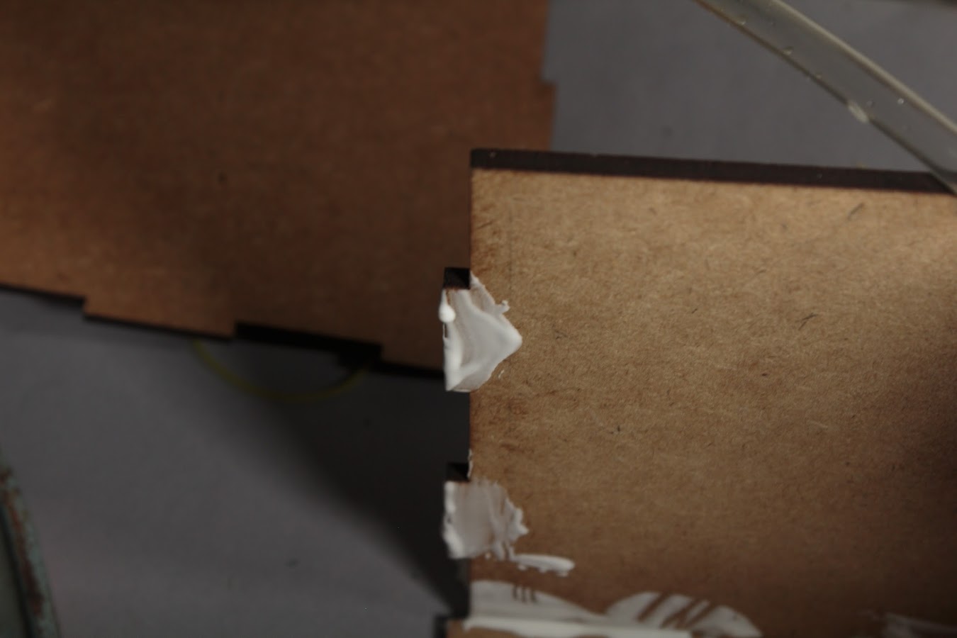

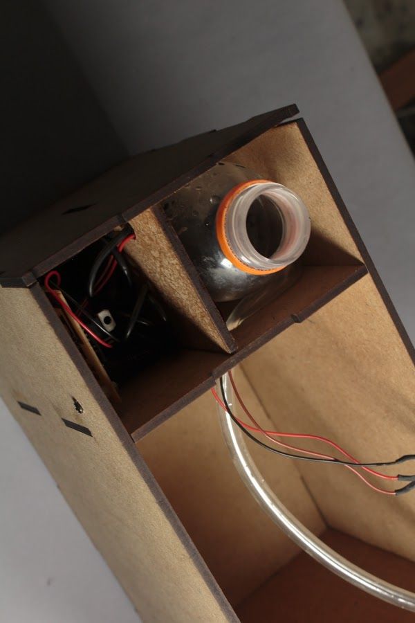

Begin interlocking the different faces of the Box and ensure that bottle fits snuggly into its designated area.
Apply wood glue or an adhesive to seal the entire box
