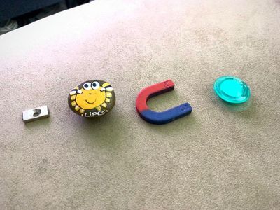

Opening your drawer, you found your trustee Micro:bit & a piece of magnet.

  • 1 x Magnet (or any fridge magnet)

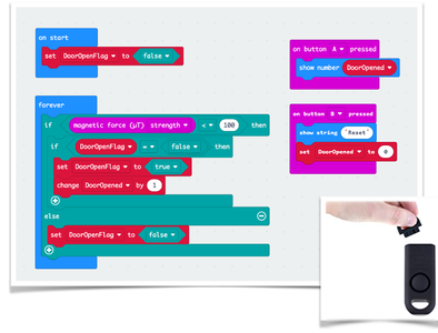

Step 3: A Simple Door Opening Detection / Trip Wire System
We will now build a simple tripwire system using our Micro:bit with the piece of magnet. The logic of the tripwire is rather simple, our Micro:bit will continuously read the magnetic field around itself. And we will increase the count (DoorOpened) by one whenever the magnet is pulled away, passing the threshold set in our simple MakeCode program. (100 is a sweet number that will work in most cases, but you are free to adjust it to increase the sensitivity). It is really important for our Micro:bit to only add the count when it registers a change in magnetic field strength, passing the threshold (Magnet close-by to pulled further apart). We create a variable to be used as a door opened flag (DoorOpenFlag).
The following flow-diagram will better illustrate how the program works.
Step 4: Putting the Codes Together
Step 4.1: Create the codes as illustrated in the flow chart. Or, open the following MakeCode link with your browser directly: https://makecode.microbit.org/_iXd3Xtbtt5aw
Step 4.2: Place a piece of magnet close to your Micro:bit
Step 4.3: Download the code to your attached Micro:bit (You may need to adjust the threshold of 100 based on the result in Step 2.5)
Step 4.4: Once the program is loaded & running on our Micro:bit, move the magnet away & back to close proximity to the Micro:bit a number of times.
Step 4.5: Press Button A on your Micro:bit to display the number of times "Door" has been opened since our Micro:bit starts running the program.
