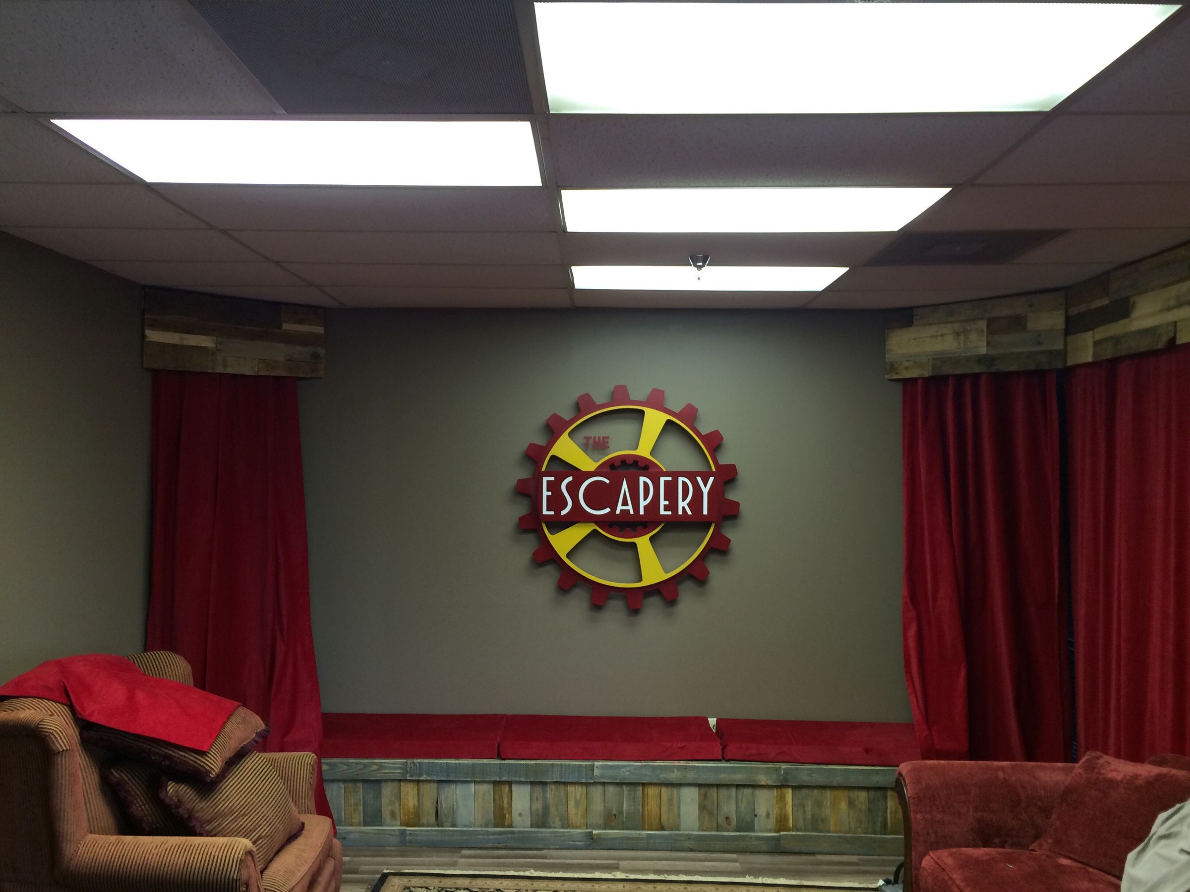

We made this bench for the lobby of our business. We knew we needed cushions, but did not have the budget to have a seamstress make them for us. After exploring options, I found some ideas on Pinterest and combined them to create the look you see here. This was very affordable (all three less than $100 total) and easy- it took about 2-3 hours. These are the supplies I used:

Since my cushions were large, I did this step on the floor. I was using a curtain panel and the width was already close enough. I cut the fabric and stapled over the long portion of the cushion. Before you staple, play with how tight you want to pull the fabric. Too much and you will have tugs in the top edge of your cushion. Not tight enough and your edges will not be crisp enough or have wrinkles.
Now comes the trickiest part- the corners. I folded mine like a present- see photos for clarification. I experimented with some other methods and this worked best for my fabric. Don't make all your folds and staple the end result. Staple as you go- one fold and some staples. Gather excess fabric and staple. Continue until you are finished. There will be some lumps, no worries unless they are really large- trim really large lumps.
Step 5: Add Backing
At this point, the underside of my cushion was none too pretty. We would be occasionally removing the cushions as our bench has storage and we also did not want the staples to scratch the top of our bench. So, I laid my cushions on a piece of black felt and traced with a pencil (the graphite shows on the black) and cut the felt to be about two inches short all around (so the felt is at least an inch from each edge and does not show). Next I used hot glue on about one foot sections of board and laid the felt over the hot glue section by section. Mine was not perfect. I had to occasionally tug the felt to cover staples and a few were left exposed, but over all it gave the cushions a more finished look.
Step 6: Finishing Touches
All that is left to do is flip your cushion over and use your fingers to straighten the edges and create the square look. For the amount of time and money invested, I thought that these looked great!
