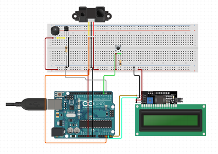

Step 2: Fix Wiring of Components
As seen in the materials section, you have need of several components and lots of wires, and a single resistor. This is pretty much all you need for this step, so just to repeat:
  • Lots of wires (around 20, for organizing colors or in case some break)
  • Two resistors
  • The SHARP infrared proximity sensor
  • A transistor
  • The LCD display 2x16 I2C
  • Your breadboard
  • Arduino UNO
  • Arduino Button
  • Arduino Buzzer

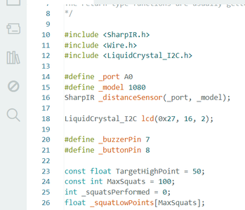

Now, we are going to attach the wires in the correct places according to this schematic attached. If you follow this schematic, everything should work as intended. (WARNING! There is one exception. The schematic shows that the buzzerpin is attached to Analog pin 2 and the buttonpin is attached to Analog pin 3. You can either attach the wiring this way and go to this section of the code (see attached image) and change the button and buzzer pin accordingly, or change the wiring to fit the correct pins assigned in the downloaded code).
Now supply the Arduino with power and exercise some simple tests to make sure that the wiring is indeed correct and that the program works. If so, continue by soldering the wires into the breadboard in the following way (look at attached picture. This might seem confusing, but basically, make sure the buzzer and button are on the other side as the wires so that the wires are not visible from the outside of the device.
If you have soldered all wires correctly, you are done with this step.
