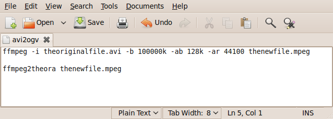

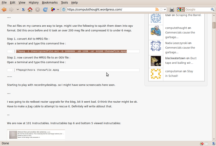

In part one we will move from an avi file to an mpeg (intermediary) file. Since I do most things on a remove server where I do not have access to it's keyboard or monitor, I will use the command line. I will usually make a file of the commands needed and then cut and paste to the command line. Makes things very easy to do. Now use this command to make the first conversion. Warning: it will create a very large file. In this case of over five hundred megabyes. Do not let that alarm you. It is all part of the process.
$ ffmpeg -i h5815.avi -b 100000k -ab 128k -ar 44100 h5815.mpeg
Step 3: Step 2: Moving From Mpeg to Ogg Theora.

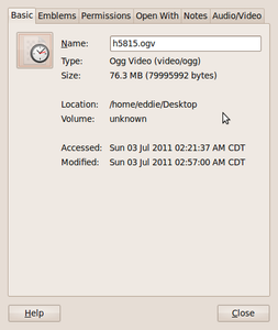

In this step we will see a dramatic reduction in the size of the file. Certainly most of the better video sites now support the ogg video format. If they do not, they should eventually. In this case we will go from over five hundred megabytes to under a hundred megabyes so that the resulting file is 1/3 of the original file size. So if you have 3 terabytes of avi files they could possibly compressed into just one - one terabyte drive. Awesome. Note: the program will name your output file for you.
$ ffmpeg2theora h5815.mpeg
Step 4: Finally.
Watch the final ogg theora version of the video and make sure all is ok.
Delete the humongous mpeg file.
You might want to keep the original avi file until you can make a good backup of the ogv file.
244 gigs to 76 megs. Less than a third of the space.

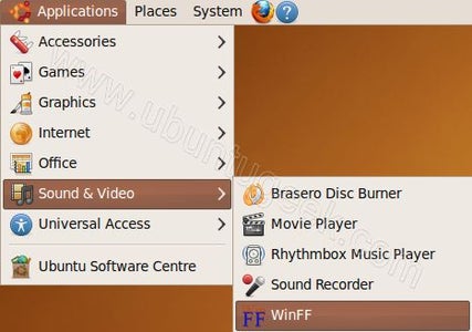

Step 6: Gui for Ffmpeg.
I think the MSWindows version comes with a gui standard. While researching I found a gui front end for ffmpeg, so it is pretty much a point and click. You can certainly test it.  To install it, use the package manager or:
$ sudo apt-get update
$ sudo apt-get install winff
Winff should show up on the Applications > Sound and Video menu.
