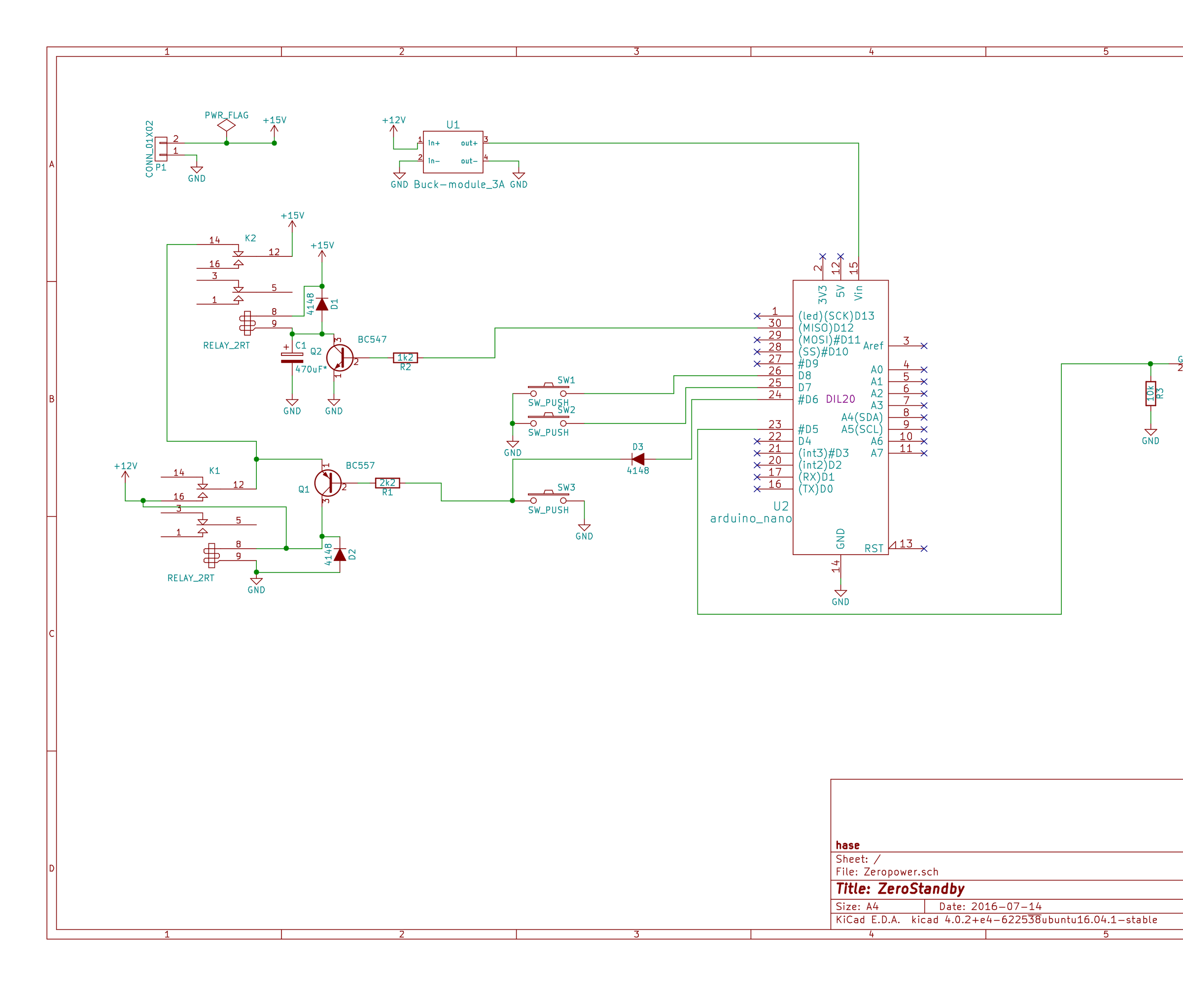

Step 2: The Controller Circuit
Its actually very simple.
If you read my other instructable, the circuit may look familiar. Probably because it's identical.
The three pushbuttons are actually one rotary encoder; I was simply too lazy to create an encoder symbol for KiCAD at the time. I only drew the circuit to show you, I made the prototype just by seat of pants. (which is usually a bad idea and will bite you in the backside like it did me. Different story altogether).
The pushbutton in the encoder - sw3 in the schematic - turns the whole contraption on and after that serves as a pushbutton for the Arduino (model Nano V3 in this case, but any AVR Arduino would do).
The "switches" sw1 and sw2 are the A and B phases of the rotary encoder.
To read the encoder, I use the ClickEncoder library, not because I think it is the best implementation out there (and the number out there is approaching n-squared; n being the number you can actually overview).
But the lib works well in this single-encoder use case, provides acceleration (non-linear counting of pulses depending on rotational speed; much like mouse-pointer acceleration) and click, double-click and hold/release differentiation for the button.
All I needed.
The circuit has two outputs: the 12V controlled voltage to feed the LED driver board (not shown) and the open drain of the IRLZ44 Power MosFET.
The LED (also not shown; I was really lazy or sloppy when drawing that :-) is connected to the positive output of the driver board and to the open drain of the FET.
Caution: This circuit can only work with the el-cheapo non-isolated driver boards that have a common GND for input and output. All the boards I saw on eBay fulfill this criteria, since that is pretty much the cheapest way to implement a buck or boost converter.
Errata: the circuit show has the FET driven by pin D5, but I moved that to D9 later to get a 10bit-PWM.
A word on the MosFET: I like the IRLZ44, probably because I got a bunch of them quite cheap some time ago.
But the same circuit would work well with other FETs in its place.
Since we are driving the FET from a controller pin, it is essential to use a "logic level" FET: these will open quite a bit or even totally when driven with a 5V logic signal. Regular (non-logic-level) FETs will require gate voltages in the 10V-15V range to fully open; old workhorses like the BUZ10 will not even start to significantly conduct at 5Vgs.
And a word on Power MosFETs in general and how to use them: not like this :-)
You should always limit the gate current (which actually I do: the AVR output is effectively current-limited...) and use a gate drive that ensures fast turn-on and fast cut-off.
The reason your want the transitions to be fast is this: each transition burns a certain amount of energy (that is: converts electricity to heat) inside the transistor. This amount is higher with longer transitions; so if your gate driver takes his sweet time to charge or discharge the gate, the heat buildup in the transistor will be high.
Since each transition burns this amount, the switching frequency becomes a multiplier: Losses will increase linear with the switching frequency (provided the gate drive stays the same).
In my experience, an AVR pin will drive an IRLZ44 gate just fine, if the AVRs power supply is above 4.8V (but below the chips maximum of 5.5V, of course).
And the transistor will not require a heat sink if switched at a few hundred Hz (as in typical lighting PWM applications). But be careful and use a heat sink if in doubt.
