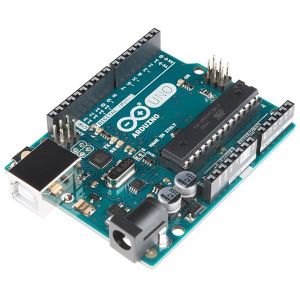

  • Arduino UNO

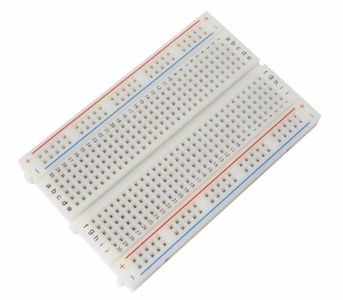

  • Protoboard

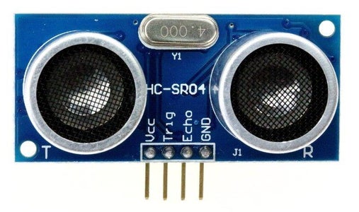

  • HR-SC04 Ultrasonic Sensor

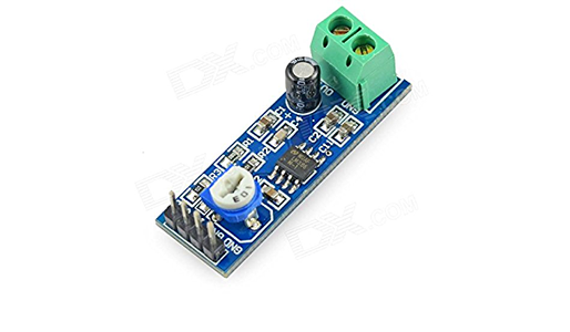

  • LM 386 amplifier

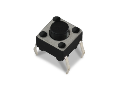

  • Push Button

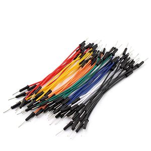

  • Dupont cables or any kind you have

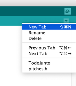

Before starting the project it is important to know exacly what do you want the doll to do, that is why we create the flow diagram in order to follow its steeps. Also, it is important to add a new tab in your arduino code and call it pitches.h, inside this tab, copy the programe pitches.h above and paste it there. Then copy the SuidGameDoll code the the main tab of your code.

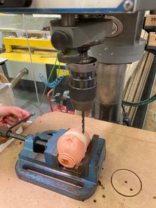

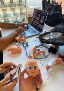

Step 3: Install Ultrasonic Sensor
Pierce the dolls eyes to the size of the sensor and glue in in place.
Step 4: Head With Servo
In order to connect the head to the servomotor, you will have to separate the head from its body and build or 3D print a piece which will connect the head to the servo. The servo will be place inside the body and right below the neck.
