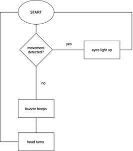

First, we analyzed the game series and established the functions we wanted to realize in our project in order to create our flowchart.
Then, we listed the necessary components, and next we looked for a 3D model of the doll, which we printed out and made the necessary changes to allow for the wiring.

Step 3: Flow Diagram
