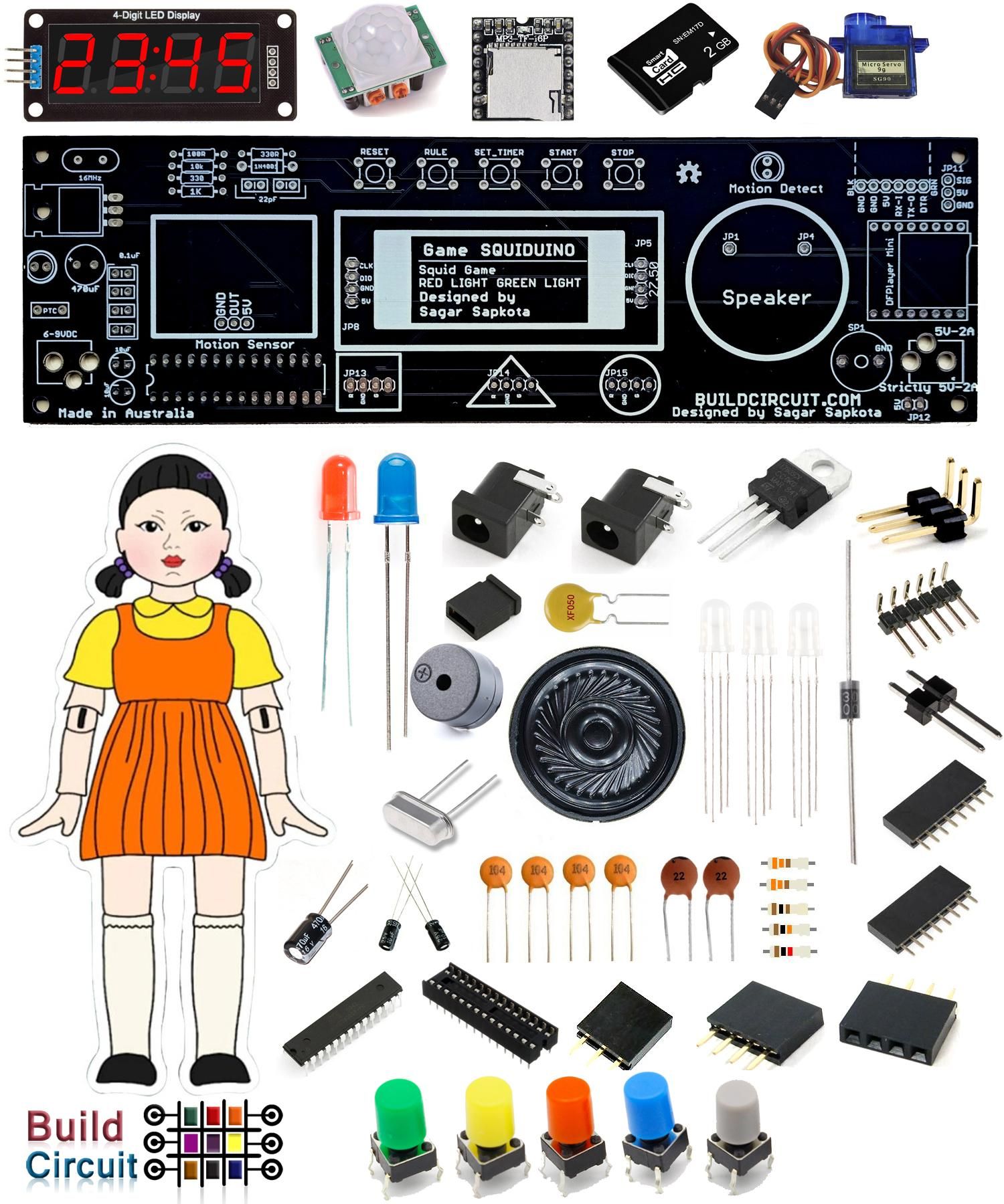

I redesigned this DIY Arduino kit to build this project. The major parts of SQUIDUINO are:
- PIR Motion sensor
- MP3 player with 2GB microSD card. The 2GB microSD card comes with 8 sounds to give you a feel of Squid Game. Download the sounds here: With Gunshot and With Guitar
- 0.56″ TM1637 display module working as a countdown timer
- SG90 Servo
Other supporting components are:
- Buzzer
- 3 x RGB Common cathode LEDs
- 8 Ohm Speaker
- Buttons
The device is fully programmable, you will need an FTDI basic breakout board to program it. You can use the Arduino IDE software to program the kit.

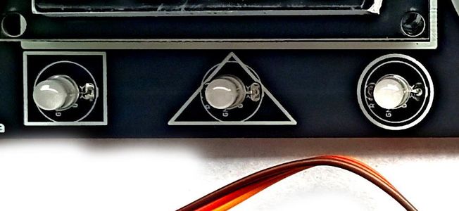

- There are 3 RGB LEDs that turn RED when the circuit plays RED LIGHT sound and turn GREEN when the circuit plays GREEN LIGHT sound
- The three RGB LEDs are inside circle, triangle, and square which are the most notable shapes seen in the series.

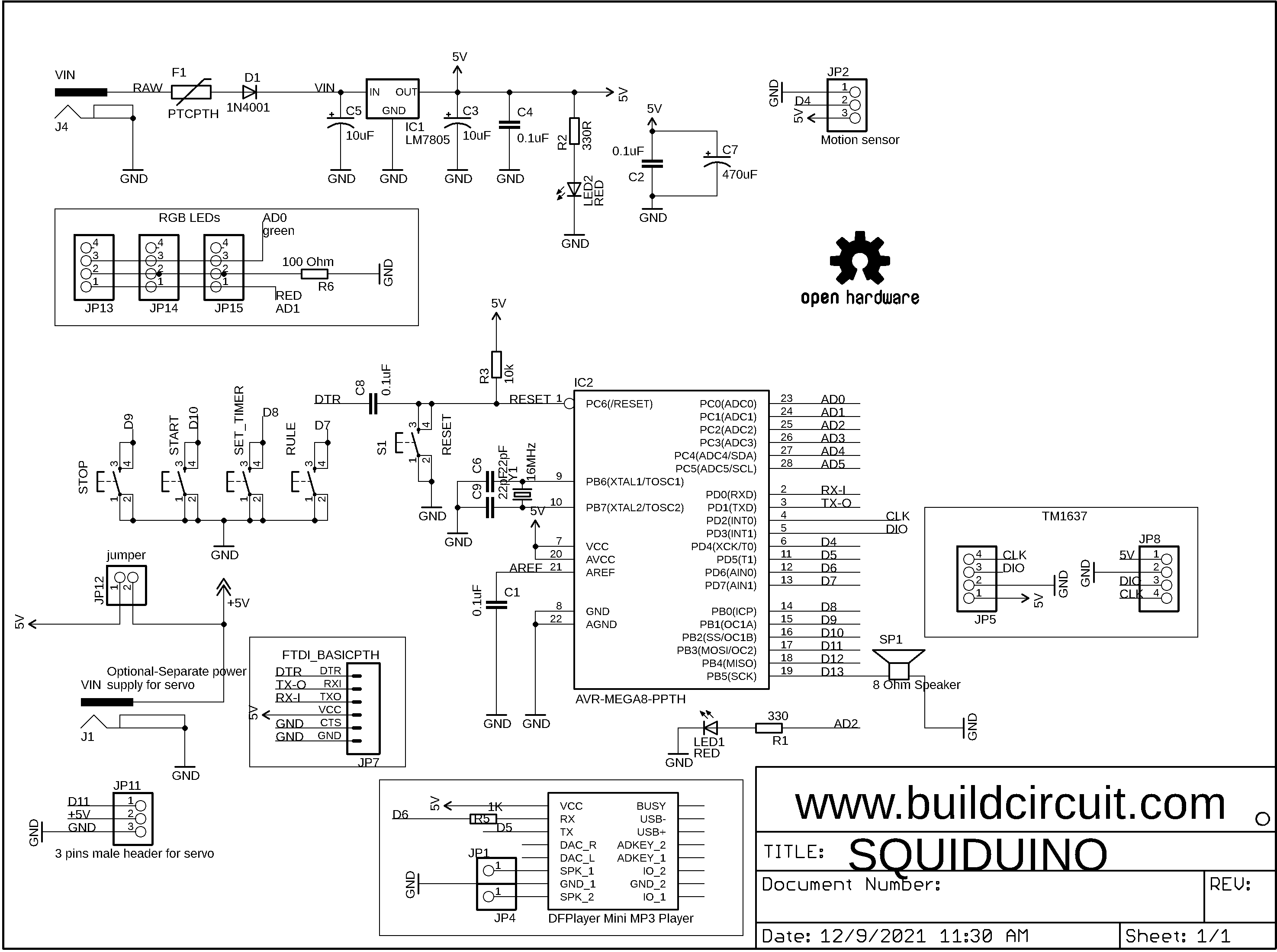

If you design your own PCB, you will need these components and if you decide to make it using Arduino UNO, you need to buy the components shown on the wiring diagram, you can also see the schematic.
Arduino users need to buy these components:
- Arduino UNO
- DFPlayer-mp3 player
- Motion Sensor
- 8 Ohm Speaker
- TM1637 module- If you are using Arduino UNO, you need to use v1.2 TM1637 module. I have programmed for both 0.56" TM1637 display and the V1.2 module. The Arduino Sketch used for 0.56" module does not work for the other one.
- 1 x BLUE LED(used as motion detection indicator )
- 3 x Common cathode RGB LED
- 4 x tactile switches/buttons used for Start, Stop, Rule, and Set Timer functions
- 1 x Buzzer (It is played after the timer reaches 00:00)
- 1 x SG90 Servo
- 1 x 1K Ohm resistor
- 1 x 220 Ohm resistor
- 1 x 100 to 220 Ohm resistor to connect to RGB LED
- 1 x 2G to 8GB microSD card(this is used to store the mp3 files)

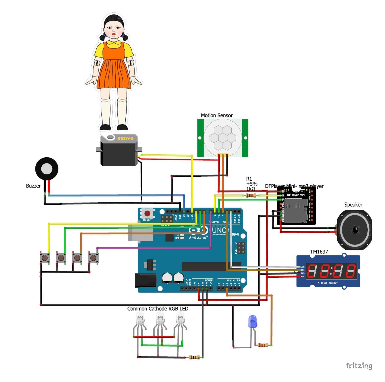

Step 1: Connect All the Modules and Components to Arduino
Connect all the modules and components to your Arduino as shown on the wiring diagram.
Please bear in mind these points:
- As mentioned earlier, you need to use v1.2 TM1637 for this project because the Arduino sketch shared on Instructables is written for this module. Note that v1.2 module uses TM1637Display library.
- The servo draws a lot current, so, if your Arduino is interrupted while the servo is moving, you will have to use a separate power supply for the servo only. In that case, you will need a 5V-1A power supply(DO NOT EXCEED 5V). Connect GND wire of servo to GND and 5V wire to 5V of the power supply and connect D11 of Arduino to data wire of the servo. So, make sure that you use one power supply for Arduino, either use a USB cable OR use a 5V to 9V power supply and connect it to the DC barrel of Arduino and use another 5V-1A supply for servo.
