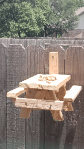

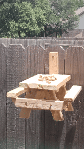

  1. To hang from a tree branch or other overhang: Use any strong twine or rope to make a loop through the bench's legs and hang from a tree.
  2. To attach to fence: Screw one side of a 5 or 6-inch beam onto the side of the bench and screw the other side onto a fence.
Step 9: Finished Product

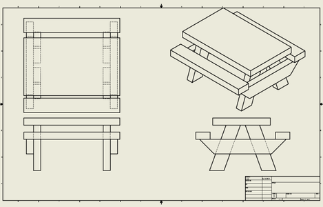

To actually begin work on the bench, I started off making a CAD of the bench on Autodesk Inventor, which took me two tries to perfect. One issue I encountered early in the design process was attaching the beams that make up the tabletop to each other. To fix this, I made supports that could connect the four beams together.
When I was done with the CAD, I perfected the dimensions of the bench to make sure it would be easy enough for a person to make without advanced tools. With the completed CAD and dimensions in hand, I went on to make the bench and documented each step, as in the 9 steps before this.

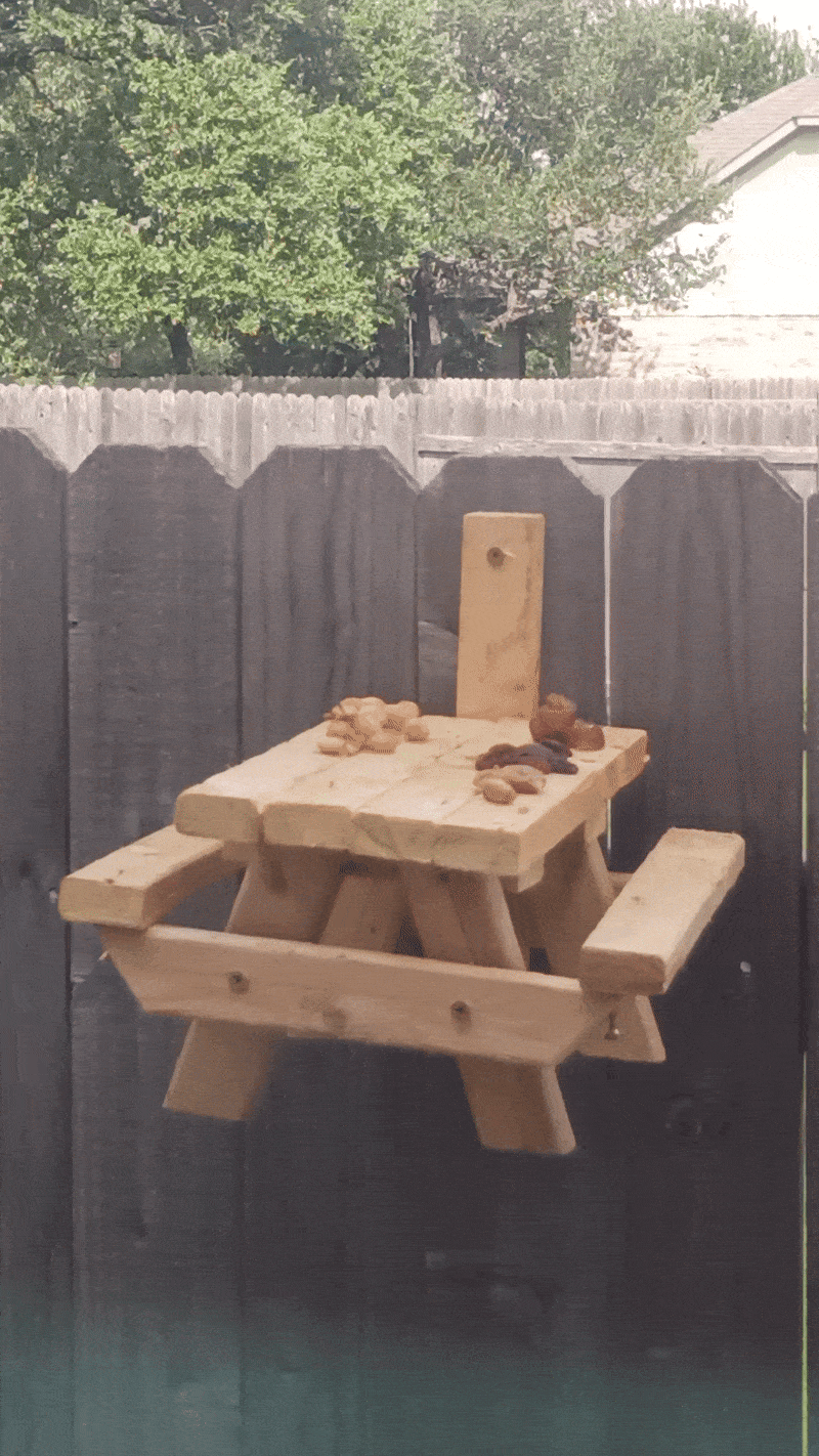

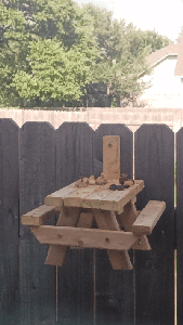

Step 11: More Bench Visitors!
