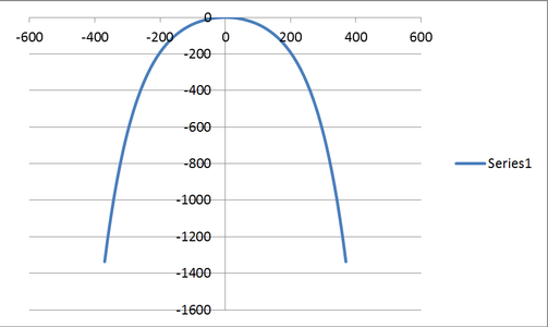

I figure if I am building a scale model of the arch I might as well take pride in its accuracy. And a quick trip to Wikipedia gave me the exact formula used in the design.
Step 2: CADing the Arch

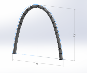

I took the formula I found on Wikipedia and graphed it in excel. I imported a screen shot of the graph into a sketch in solidworks. I felt like a 4' tall arch would be a good first so I modeled an assembly of cans that traced the silhouette of the graph.
I used the assembly in solidworks to come up with the angles between each can.

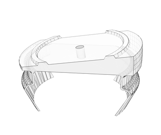

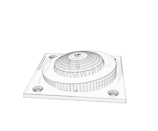

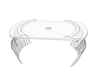

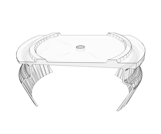

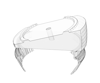

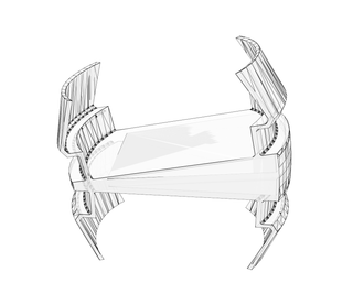

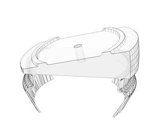

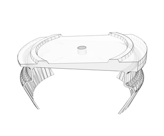

One challenge for the project was to make the joints between the cans as discreet as possible. I also need the joints to be strong enough to hold the weight of the arch, and accurately hold the cans at their angles.
My solution to these demands is a 3d printed elbo/cap joint.
Using an instructable I found (Great Idea) I can take the tops off empty cans and replace them with my own caps. These 3d printed caps will have the necessary angles built in and can be connected to the next can with a wood screw.
I printed out all the caps and labeled them for where in the arch they need to be.
