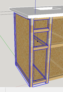

Step 7: Going to Show the Details of the Panel
With my bad english and without wake up my sons I try to show better the panel part.
I add video because some part are hidden from schema or difficult to see.

Step 8: Junction
All junction is a square of 32mm, all tenon is 12mm large and 5mm depth.
The groove for panel at the same way is 12mm large and 5mm depth.
As you can see the panel is 12.7mm and the groove is 12mm, to insert panel in the groove I planed edge round with with my trust record hand plane.

Step 9: Back Legs
The back legs is 4:
- 2 * 840mm with 2 stopped groove (stopped at 30mm to the base), the grove one is front and left and one is front and right but the legs is square so they are equals.
- 2 * 840mm with 3 stopped groove (stopped at 30mm to the base)

Step 12: Back Junction
All parts have vertical tenon.
- The upper part have bottom through groove on the bottom.
- 2 * 196mm
- 1 * 310mm
- The middle have 3 through groove (up, down, front).
- 1 * 310mm
- The bottom have 2 through groove (up, front).
- 2 * 196mm
- 1 * 310mm
All lengths are tenon included.

Step 14: Central Up Junction
I add this to sustain better the table, It's 310mm length without groove
