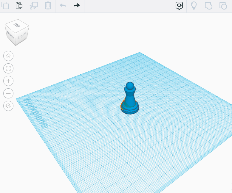

Step 1: Building the Base
-Place a cylinder on the work plane
-Scale to a height of 3mm and a diameter of 50mm
-Place another cylinder in the center of the last one and scale to a diameter of 10mm and a height of 76mm
Step 2: First RIng
-Place a taurus on the work plane and scale it to a diameter 25mm and a height of 5mm
Step 3: Second Ring
-Place another taurus and scale it to a diameter of 32mm and a height of 7 mm
Step 4: Third Ring
-Place another taurus and scale it to a diameter of 38mm and a height of 8mm
Step 5: Fourth Ring
-Place another taurus and scale it to a diameter of 50mm and a height of 12mm
