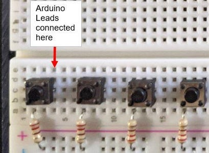

Trim the leads on 12 220 ohm Resistors to 1/4 inch and bend them to 90 Degrees.

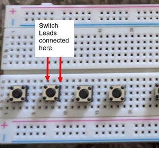

Step 3: Insert Switches
Insert 3 groups of 4 buttons to the circuit board, each lead of the button should be placed in separate rows of the breadboard.
Step 4: Insert Resistors
Insert one resistor for each switch, one lead of the resistor should be connected to the ground bus and the other lead should be connected to the same row as one of the switch leads.

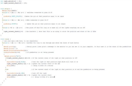

Step 5: Wire Buttons to Arduino
Connect wires from the buttons to the Arduino, the first button should connect to pin 22 and the second button will be connected to pin 23 and so forth until pin 34 on the Arduino.
