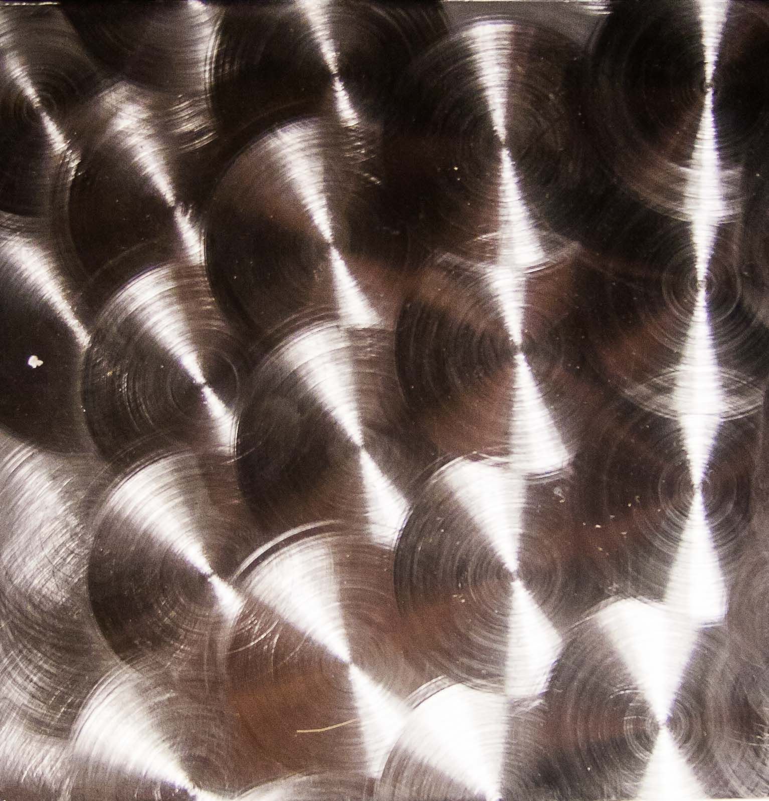

This was all concept work in CorelDraw for my customer so they had a rough visual of how the sign would look in the end. The texture was a hand hammered texture I came up with just for the job, I took a picture of it and added it to the Rough concept Corel file. The first step I took was cutting my SS into 4x4in sheets to play with different textures to use for the final sign to show my customer our options. The final one I did ended up being the winner, I created it by putting a curved 1/8th inch round bar behind the sheet and hitting it with a soft deadblow hammer. After that sand blasting it to dull the finish to an eggshell or flat and then sanding off the high spots with 220 in on orbital sander to brighten the high spots. At the same time I picked up some plastic samples that I finished a few ways, the supplier only had gloss black in the thickness I needed so I sanded one sample with with an orbital palm sander and the other went through the sand blaster. we ended up using both to create a subtle 2 tone. The sanding came out black while the sand blasting chalked out to be a little grey.

When I setup my cut file I left borders all the way around to make it easier to form, rather than beating on it with a hammer and then texturing I wanted it to stay fairly flat, that's why I textured and then cut. It was cut on a water jet and then all the edges went through a sheet metal break. It was then tig welded on the corners, ground and sandblasted to blend out and hide the welds and sanded with the 220 again.
