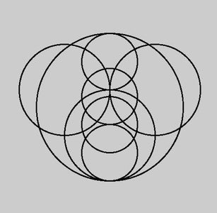

Using the geometry taken from the proportions of the Cathedral [image 1], the eight circles were made using Processing [image 2]. The formed image and the code can be seen below:

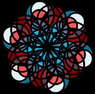

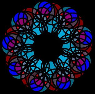

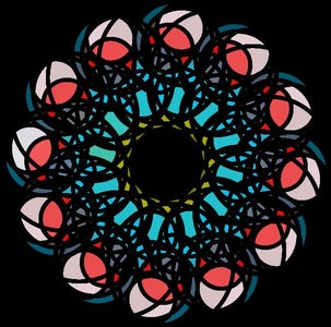

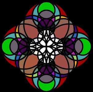

How it works: Using shapes taken from geometric proportions and Processing's "rotate" and "translate" functions, it is possible to make an infinity of "stained glass" by changing the angle of rotation, the x, and y of the translation, the width of the "rims" and the colors of the circles.
Below are examples of some of the results obtained using the same colors, changing only the angle, x, y, and width of the "rim."
