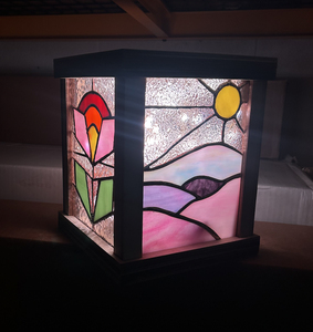

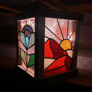

Step 11: The Four Seasons (final Design/proj)
Our final design represents the four seasons with different color schemes on each pane! All four panes are pictured in the photos below along with the final setup. Have fun and good luck with your stained glass lantern :))
